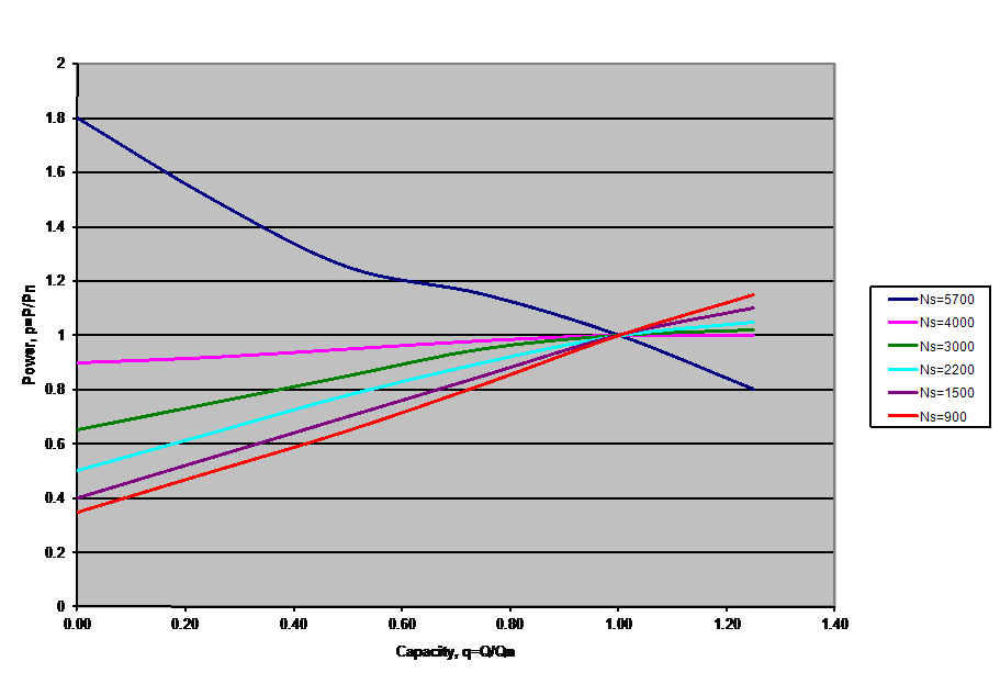

  1. The pump must have a specific speed less than about 3,000. Horsepower rises as flow increases in pumps with specific speeds in this range. Pumps with specific speeds above this have flat or negative horsepower slopes (see Figure 4)5.

Figure 4. Pumps with Specific Speeds above 3000 have flat or negatively sloped horsepower curves.
