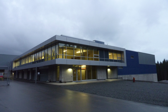

Image 1. The Nanaimo Water Treatment Plant provides safe drinking water using GE technology (Courtesy of GE)

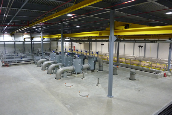

Image 2. GE’s ZeeWeed technology installed at the Nanaimo Water Treatment Plant
