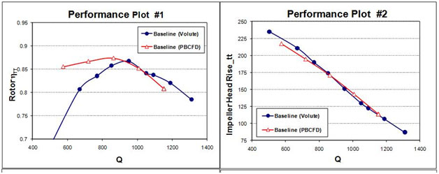

Initial trial calculations were conducted using flow analysis software for an evaluation. Key results are shown in Figure 1. The flow analysis (pbCFDR was used)matched the impeller efficiency (3a) and head rise (3b) over a good portion of the flow curve. This evaluation was for the impeller only and did not include the volute.

Measured efficiency (blue) with flow analysis comparison (red) for OEM impeller
Figure 1. Measured efficiency (blue) with flow analysis comparison (red) for OEM impeller (3a – efficiency and 3b – head rise)

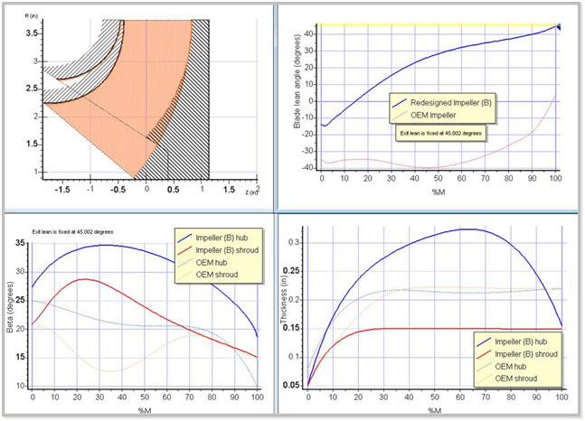

The redesign required attention to several issues. Meanline calculations revealed that the inlet eye was not optimum for this application. Blade loading calculations revealed that improved blade shapes would be possible. Additionally, it was clear that a sensitivity study for the exit blade height should be conducted, since the original equipment manufacturer (OEM) impeller used shallow exit blade angles (15-degree shroud and 10-degree hub). Classical guidance in this area is weak.
Figure 4 shows the revised inlet and the revised blade angles used in this study. The eye radii were reduced, and new blade angles were selected to control hydrodynamic loading, with exit blade angles of a 15-degree shroud and 20-degree hub. These are low angles, but they are more realistic for a high performance design.
New contours and blade angles for improved performance
Figure 2. New contours and blade angles for improved performance

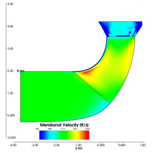

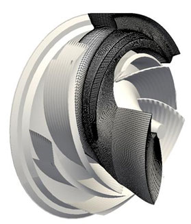

The revised blade angles were developed in a 3D geometric design program using classical through-flow calculations and then confirmed with detailed flow analysis studies as useful examples (see Figures 3 and 4). Figure 3a shows a well-defined computational grid of about 650,000 nodes with a Y+ of 32. The Spalart-Allmaras turbulence model was used in the RANS solver. Figure 3b illustrates a key result: no recirculation was found anywhere in the redesign flow field except in the shroud clearance gap, which is to be expected.
Sample impeller O-H gridSample flow field showing absence of backflow
Figure 3a. Sample impeller O-H gridFigure 3b. Sample flow field showing absence of backflow

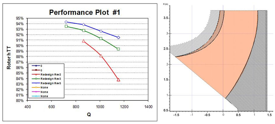

Figure 4 illustrates computational fluid dynamics (CFD) usage to study specific issues. In this example, tip depth was studied to find the best head and efficiency. The results were surprising because both head and efficiency rose with further tip width increases beyond that of the OEM design and beyond any of the standard reference guidelines. This was particularly surprising since the OEM stage had considerable instability associated with it.
 Study of impeller exit showing increased efficiency; also, increased head was f
Figure 4. Study of impeller exit showing increased efficiency; also, increased head was found (not shown)
The final improved design, therefore, had an improved inlet eye, blade shapes, blade exit angles and exit width. The same volute was used for convenience.

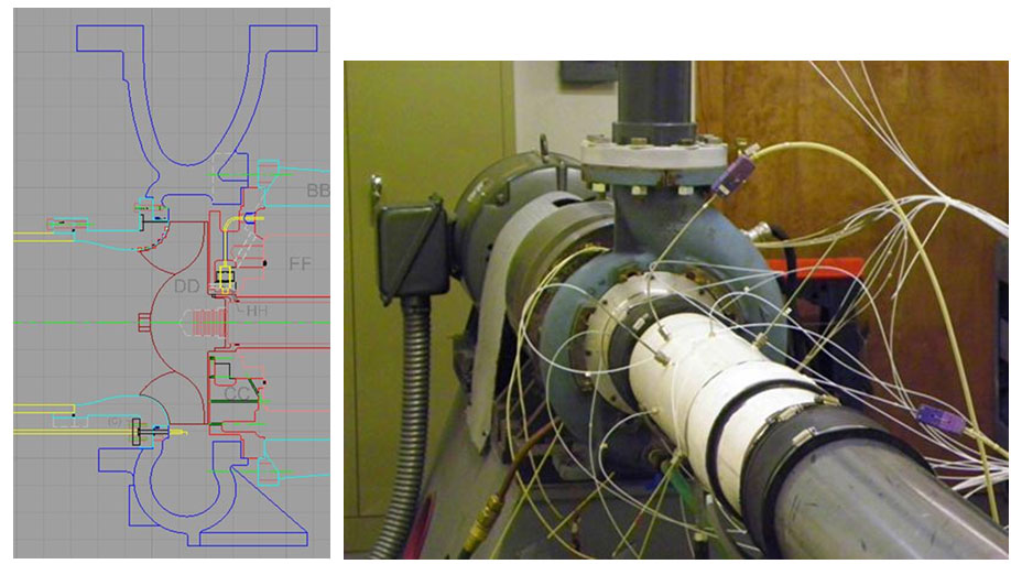

The revised design (see Image 2) was machined and tested in its final machined state. The test configuration (see Figure 5) and precise measurements of head and efficiency were conducted. The OEM volute is evident in the photo in Figure 5.
The test rig cross section and full laboratory setup with instrumentation
Figure 5. The test rig cross section and full laboratory setup with instrumentation

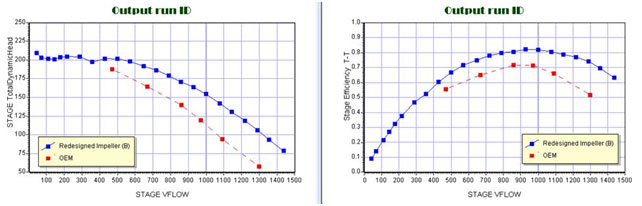

Laboratory measurements were used for further model development and design validation. Figure 6 shows the measured head and efficiency of the new stage compared to the OEM stage and tested in the same facility. Improvements of 6 to 7 percent of efficiency and at least 40 feet of head were achieved, while using the same volute. Of equal significance is that the instability disappeared without using special treatment (inlet divider) to suppress unwanted effects.
New stage measurements compared to original - blue, redesign and red, OEM
Figure 6. New stage measurements compared to original - blue, redesign and red, OEM
Comparing this redesigned stage against the original intention of the OEM stage is also instructive (see Figure 7). It checks out closely with standard reference curve expectations for a stage today. Exceptional agreement was achieved. The head curve is completely healed and the efficiency is now about 2 to 5 points above the originally anticipated and current state-of-the-art values.
Comparison of new stage performance to OEM's stated intent - gains above current
Figure 7. Comparison of new stage performance to OEM's stated intent - gains above current state of the art are evident

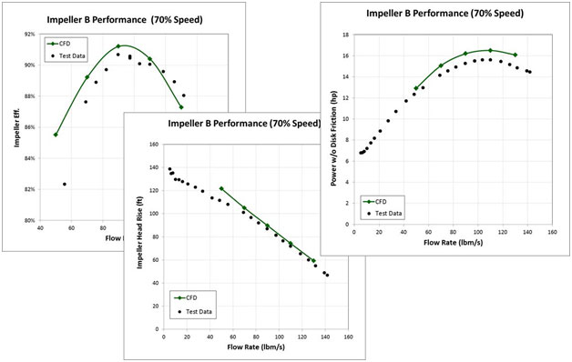

Two more points are important from this study. First, the design tools worked well for this development. The CFD results are compared to measured results on a totally blind basis (see Figure 8). The green lines were predicted before the impeller was built, and the results are shown as they came from the laboratory. Differences between the two are slight and have rational explanations.
Excellent agreement between laboratory and predicted performance
Figure 8. Excellent agreement between laboratory and predicted performance
