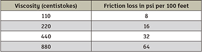

To effectively size pumps, motors and piping to meet performance specifications, operators need to know the minimum and maximum viscosity of fluids. Viscosity can affect pump suction and discharge pressure requirements and pump performance.
Table 1. Viscosity-induced friction loss in discharge pipe (Graphics courtesy of LobePro Rotary Pumps)
Viscosity-induced friction losses in discharge pipe can be considerable. For example, the pounds per square inch (psi) loss per 100 feet when pumping 50 gallons per minute (gpm) of fluid with a specific gravity of 1 through new, schedule 40, 2-inch steel pipe is shown in Table 1. This is in addition to the velocity friction loss commonly included in hydraulic calculations based on water. While knowing the highest viscosity is critical, knowing the lowest viscosity is also important, because this may result in more slip and lower pump output. Pump suppliers should be able to provide accurate estimates of pump output at minimum and maximum viscosity. Determining the viscosity of a non-Newtonian fluid can be challenging because the effects of time, force and temperature on viscosity must be understood.

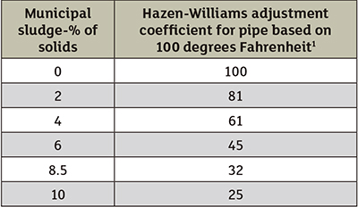

Table 2. Hazen-Williams adjustment coefficients
A research team in Canada developed another approach to obtaining a reasonably accurate model. They did a series of empirical studies at wastewater treatment plants. Based on these results, they proposed adjusting the Hazen-Williams pipe coefficient as a simplified way of including thixotropic resistance in the required hydraulic calculations (see Table 2). For example, consider a wastewater treatment plant that uses cast iron asphalt lined pipe. The Hazen-Williams friction constant for this pipe is 100 if pumping 100-degree F water. Using Table 2, the Hazen-Williams pipe friction constant is adjusted to 61 (100 times 0.61) for 4 percent municipal wastewater sludge.
