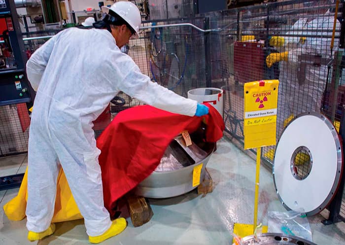

a field engineer places a foreign material exclusion shield over the pump housingImage 1. With the old RCP removed, a field engineer places a foreign material exclusion (FME) shield over the pump housing. (Images courtesy of AREVA)
The project scope included five pump replacements. The facility partnered with an international nuclear energy services company to renovate and qualify four 12-foot, 24-ton pumps, including two from Dominion’s closed Kewaunee Power Station in Wisconsin. One additional pump previously refurbished by the nuclear energy services company was used to complete the project scope.

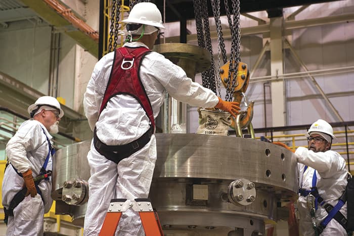

Engineers hook rigging to the pump for transport.Image 6. Engineers hook rigging to the pump for transport.

Improved processes and innovative technologies allowed the team to be proactive, which increased productivity and reduced critical path time and impacts to the schedule and other work groups. Innovative solutions for transporting and installing components also improved overall project performance. For instance, the nuclear energy services company designed a shielded transport RCP cask with one hook to up-end the large component. The cask’s smaller footprint and easy lift design simplified the process of repositioning the component, reducing polar crane and critical path time by eight hours per pump. Engineering innovations helped configure the unique style of Kewaunee’s pumps for Surry. Flow curves, piping configurations and thermal monitoring systems all required attention. Dominion worked with the nuclear energy services company to fabricate new shafts and impellers for the pumps to achieve flow requirements. Because of the RCP’s complex geometry, state-of-the-art digital measurement technology was used to measure the different dimensions of the pump components. Three-dimensional overlays of the new and old pumps identified possible deviations with more accuracy and speed than was previously possible through manual measurements.
