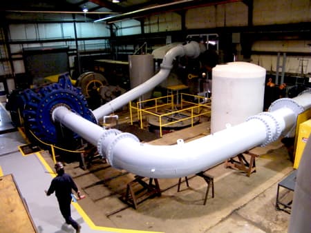

Compared to the water pump industry,  few slurry pumps intended for mining and other associated industries are subjected to acceptance tests before shipment to the customer. Experience over the past 10 years indicates that Flue Gas Desulphurization (FGD) pumps for the power industry and pumps supplied to the oil sands industry are the exceptions. A picture of a large oil sands hydrotransport pump is shown in Figure 1.
Figure 1. Hydrotransport pump set up for lab test
These industries typically require complete pump testing that includes: hydrostatic, hydraulic performance, net positive suction head (NPSH) requirement, mechanical (functional), bearing temperature stabilization, sound level and vibration. In general, centrifugal slurry pump manufacturers design their equipment to adhere to the American National Standards (ANSI) Hydraulic Institute (HI) standards, which include sections that provide guidelines and acceptance criteria for the above stated testing (References 1 -5).

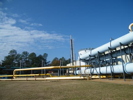

The solids estimate charts in Reference 1 generally do not take into account design variations, providing uncertainty to the performance to be delivered on site. At times there may be limited test data or experience on particular slurry, which may make it necessary to perform bench-scale, prototype or full-scale testing. In those cases, an experienced test facility can be beneficial in obtaining both pump solids effect and pipeline transport characteristics necessary for properly designing the pipeline system and applying the best pump equipment for obtaining the least Total Cost of Ownership (TCO).
[[{"type":"media","view_mode":"media_large","fid":"365","attributes":{"alt":"Effect of average particle size and impeller diameter on H, and Rh (for solids, concentration by volume, Cv=15 percent with solids Ss=2.65 and a negligible amount of fine particles, impeller diameters are given in mm and inches).","class":"media-image","id":"1","style":"float: left;","typeof":"foaf:Image"}}]]Prior testing at a hydraulic test lab (see Figure 4) obtained pump solids effect data that is used today when selecting pump equipment for both oil sands tailings and hydrotransport applications. The Syncrude Southwest Tails pumps were in fact tested on a sample of the actual tails. Here the head and efficiency ratios (HR and ER respectively per Figure 2) for this full scale pump were determined to be 0.96 and 0.92. Also, half-scale Syncrude Aurora Mine pumps were tested on the hydrotransport slurry where the head and efficiency ratios were determined to be 0.93 and 0.80.
Figure 4. View of a hydraulic lab slurry and water test loops.
While slurry tests are an improvement over clear water tests, they also have limitations such as the increased number of pump passes and slurry degradation. In most cases, these challenges can be addressed and accounted for when applying results to the field applications.

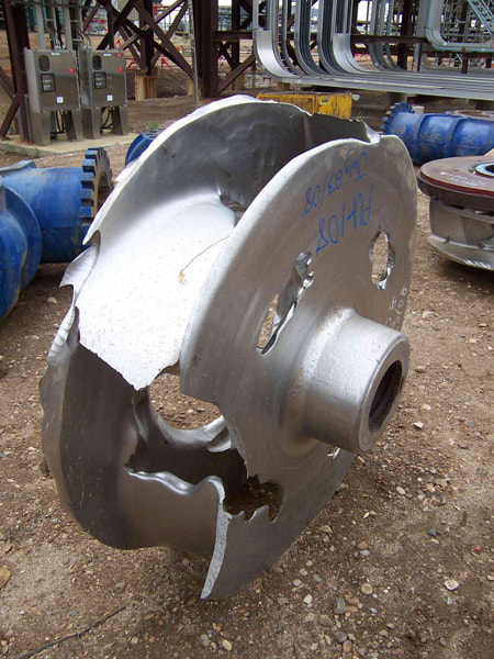

Effect of Wear
A slurry pump is expected to suffer wear over time. Parts are generally left in until they are severely worn. It is obvious from the wear picture in Figure 5 that this negatively affects the performance.
Figure 5. Worn oil sands impeller
Reference 11 provides some details of the effect of wear on performance. This only provides a general guide, which in practice could vary. In practice, a generous allowance at least must be made to the driver power to allow for wear and effect.
