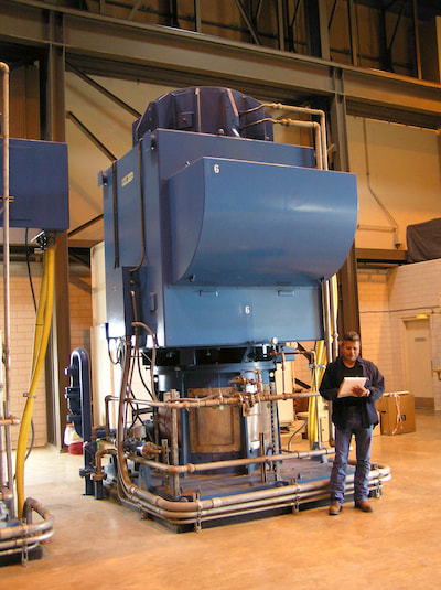

5,500-hp vertical pump lineup at the Richland Chambers Lake Pump Station.
5,500-hp vertical pump for scale.

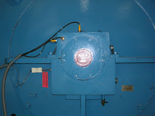

Vibration sensor pick-up on a 5,000-hp horizontal pump. Typical set-up for all horizontal pumps – 1,000-hp through 5000-hp.

Vibration sensor pick-up on a 2,500-hp horizontal induction motor. Typical set-up for all horizontal motors -- 1,000-hp through 5000-hp.
