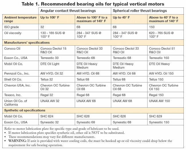

Lubrication
Table 1 lists some turbine oil lubricants that are suitable for use in vertical motors, as well as the ISO grades and corresponding viscosities. It is important to use the correct viscosity relative to the ambient temperature conditions of the motor application. If the oil is too thin (low viscosity) to maintain the separation of the rolling elements and races, the bearing will be damaged. If it is too thick (high viscosity), fluid shear in the oil will create excessive temperature that will quickly degrade the oil.
Figure 7. Steady bushing
Large, enclosed motors and motors with roller bearings usually require external oil cooling. The extra material and effort necessary to provide this can often be avoided by using synthetic turbine oil. The synthetic will operate successfully at temperatures 30 degrees C higher than mineral-based oils.
Replace the oil according to the motor manufacturer's guidelines. As an alternative, test it regularly for oxidation, contamination (e.g., wear metals or moisture) and viscosity, and then replace it when tests show degradation.

Table 1. Recommended bearing oils for typical vertical motors
