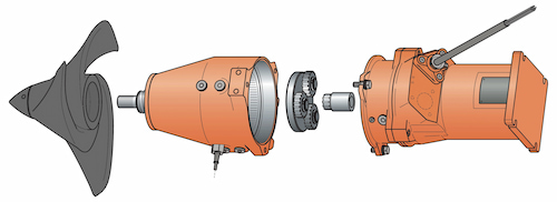

Coordination of motor, gearing configuration, and propeller design can best be achieved in mixer lines that are modular in design. These are mixer lines in which motors of different horsepower can be combined with various gear ratios and precise propeller sizes, types and styles to achieve optimum energy-to-thrust ratios.
A high horsepower-to-amp draw ratio for mixer motors results in greater torque, less heat build-up, and greater reserve.  This can be achieved most simply through the use of planetary gearing in the basic mixer design.

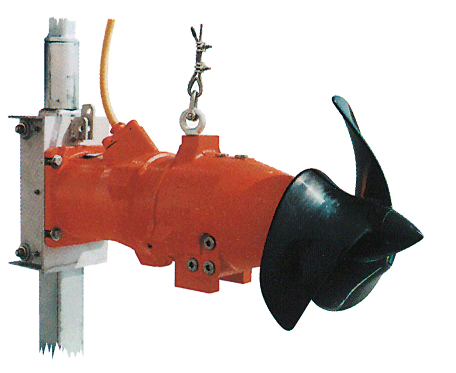

Propeller blades that are engineered to perform aerodynamically, much like the wing of an airplane, are essential to the achievement of maximum efficiencies.
As this type of blade moves, it creates lift and thereby draws liquid through the “created” low-pressure zone, which is generated by the passage of the blade. (This is more hydraulically effective than the effects achievable with flat blades, which basically push the liquid in front of the blade to generate flow.)
Studies have shown that the aerodynamic blade designs result in 2X to 3X greater thrust efficiency than the thrust efficiency of comparably sized flat blades.
Aerodynamic blade designs result in 2X to 3X greater thrust efficiency.
