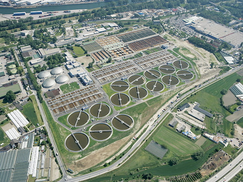

Ideally, the flow of wastewater from collection points at residences, offices and commercial establishments to wastewater treatment plants would be completely gravity-powered. This is rarely possible because of economic or physical limitations. The most common challenge is flat terrain, which cannot easily be graded to promote wastewater flows. As a result, lift stations must be employed to move wastewater to a higher elevation and eventually to a wastewater treatment plant (see Image 1). A typical wastewater collection system in a county or large city will have hundreds of lift stations, with smaller lift stations feeding into larger master lift stations. These, in turn, feed wastewater to the treatment plant.
