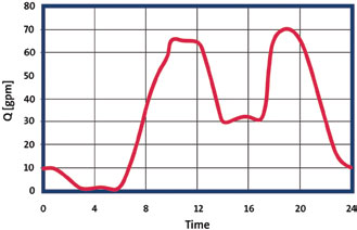

Typical domestic water consumption flow profile for a small commercial building
Figure 1. Typical domestic water consumption flow profile for a small commercial building
The flow profile in Figure 1 indicates that the demand increases in the morning and in the afternoon to the maximum flow, and gradually drops off and stops in the night hours. Peak flow is required for three hours of the day. The flow is mostly less than 50 percent of peak flow. In this example, a pump system with two 50 percent pumps would match the flow profile compared to a single 100 percent pump, and would ensure that the system operates near peak efficiency. One 100 percent pump would run near peak efficiency for less than half of the time. This example shows relatively small flow requirements, but the same holds true for larger flows where even more energy can be saved.

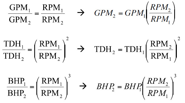

The Affinity Laws state how a pump's performance changes with changing pump speed (RPM).
 Equations
Small reductions in pump speed can create large reductions in brake horsepower (BHP). The brake BHP changes by factor of the cube of the speed change ratio.

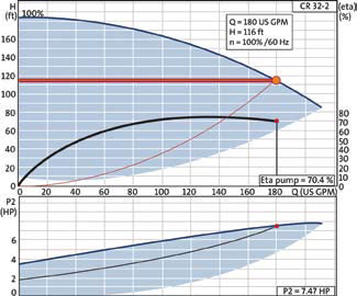

Figures 2 to 4 show an example of a constant pressure application with two different flow rates that compares a VFD-controlled pump to a fixed speed pump with a pressure regulating valve. In this application, 116 ft constant pressure is required at 180 gpm and 90 gpm.

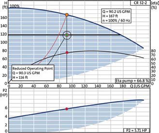

Figure 4 illustrates a curve for a constant speed pump and a pressure regulating valve (PRV) to maintain the required pressure (116 ft). This system builds 167 ft of pressure at 90 gpm and uses 5.7 bhp. The PRV reduces the extra pressure. However, the PRV wastes energy and requires periodic maintenance. This can be eliminated with VFD-controlled pumps.
If the reduced operating condition was required for 50 percent of the time and operated 24/7, using a VFD system saves $750 in energy cost compared to a PRV system. The calculation is based on a $0.10 kWh energy cost and 85 percent VFD and motor efficiency. A system with relatively low speed reduction (15 percent) saves significant energy.

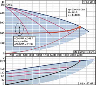

Figure 5 shows a four-pump system with a maximum design condition of 2,200 gpm at 266 ft boost. If the design pipe friction loss of the system is 20 percent of the total required boost pressure (266 ft), the actual pressure boost requirement at 400 gpm is 212 ft.
Figure 5
Figure 5
Proportional pressure control decreases pressure at lower flows and increases it at higher flows to compensate for pipe friction loss.
If the pump system operates 24/7 at 400 gpm for 50 percent of the time at a rate of $0.10/kWh, the result is an annual savings of $2,592, based on an overall motor/VFD efficiency of 88 percent. In addition to energy savings, proportional pressure control reduces leaks and saves water at low flow periods by reducing the system pressure.

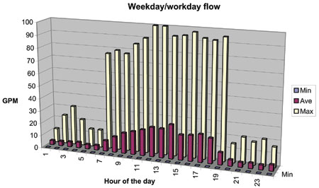

Owners of the Mani Brothers 14-story commercial office building in West Hollywood, Calif., were having problems with their potable water booster pumps. The system was in poor condition and did not provide adequate water pressure on the upper floors of the building. The capacity of the system was not known because the nameplates had been removed and the original engineering documents were not available. The triplex system included one 5 hp pump and two 10 hp pumps (25 hp connected). Each pump was equipped with a PRV, and the system controls were inefficient.
Based on the data found in the audit, an optimized system with the lowest possible life cycle cost was selected and submitted with the complete audit report.
 Weekday/workday flow
  • Flow readings logged every 60 seconds
  • Peak flows created by cooling tower demands which last 1-2 minutes/hr
  • Workday: 7 a.m. - 7 p.m. (37 percent of annual hours)
  • Non-workday flows are much lower-averaging approximately 5 to 8 gpm
Load Profile of Total Flow for One Week:
The four pump replacement booster system (3 hp each pump-12 HP connected) is equipped with variable speed frequency drive. The maximum flow can be handled by three pumps, with the fourth pump serving as an "online backup."
The annual cost of energy to operate the old system is estimated to be $10,000, with an additional $2,000 in annual maintenance and repair costs. The annual cost of energy to operate the replacement system is approximately $1,800, a savings of an estimated $8,200. Additionally, the retrofit offers eligibility for a $5,400 rebate from Southern California Edison.
