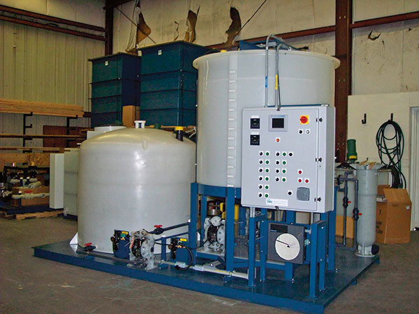

Air operated diaphragm pumps (AODP) are the workhorse of the wastewater treatment system. This type of positive displacement pump is durable enough to withstand submersion and continuous flow rates inherent in wastewater applications. AODPs are ideal for low- to mid-range flow rates—up to 350 gallons per minute—and produce enough back pressure, up to 250 psi, to move high viscosity fluids and sediment.
AODP
AODPs are used in multi-step, batch waste treatment systems to remove metal precipitation. One AODP moves the solution from the collection tank to the treatment tank. Others move the treated waste from
the treatment tank to the drain.

A typical wastewater treatment process begins as fluid builds in a sump tank. A positive displacement pump is used to move the fluid to a second tank where the rinse water flow is equalized and pushed into a reactor tank. The composition and temperature of the fluid running through the system must be considered when specifying this pump because the fluids can be corrosive and abrasive. AODPs can be configured to meet the chemical compatibility of the fluids, making them a low-risk solution.
Once the waste fluid is transferred from the sump to the reactor, concentrated chemicals are introduced to neutralize the pH balance. An electromagnetic or mechanically actuated simplex diaphragm pump, a highly controllable type of metering pump, doses treatment chemicals at a low flow rate.
This level of accuracy ensures that the fluids are treated, neutralized and clarified to adhere to local regulations.
Finally, the neutralized liquid flows into the flocculator where a chemical is added that adheres to particulates, causing them to coagulate on the bottom of the clarifier tank. AODPs are used to draw the slurry from the bottom of the tank and prime the filter press.
AODPs can handle this abrasive and corrosive mixture and produce enough back pressure to force the fluid into the filter, leaving only solid waste behind. The clean fluid returns to the treatment process before being discharged to the sewer or reused. The cake is removed from the filter press and disposed as solid waste.
