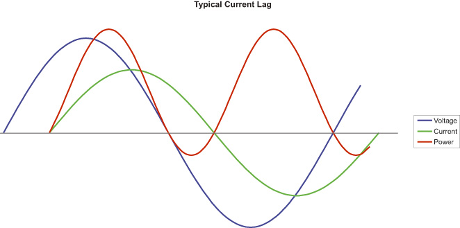

Figure 1 shows a more typical circuit that is feeding both resistive and inductive devices. The impedance (Z) of the circuit (in Ohms) is √R2 + XL2, where R is the resistance and XL is inductive reactance.
typical current lag.jpgFigure 1
This example assumes that these values are relatively equal and results in current lagging voltage by about 45-deg. The power factor of this circuit is about 0.7 (cosine 45 = .707), which means that about 70 percent of the actual power in the circuit is available to do real work. The remainder or "reactive" power is returned to the circuit as the inductive fields decay.
Now, you will have to admit that this circuit looks a whole lot better than the purely reactive one we saw last month. But almost 30 percent of the power in the circuit is still unusable, and that can result in some undesirable consequences.

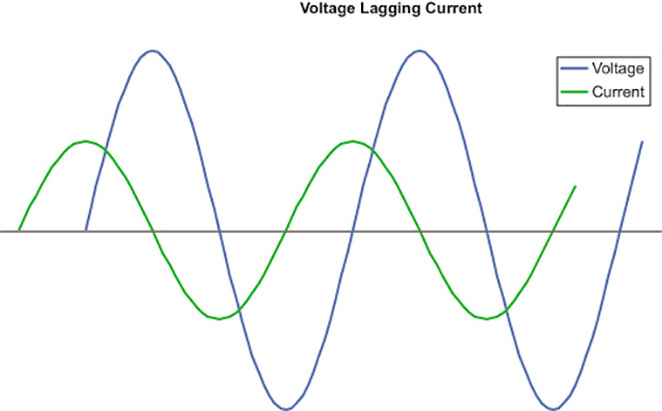

So far we have seen examples of circuits that are purely resistive, purely inductive, and one that is a combination of the two. There is, however, another type - the purely capacitive load.
The capacitor is a very simple, yet interesting and useful electronic device. It is similar to a battery in that it stores a charge but, unlike the battery, it does not produce electrons through a chemical reaction. It simply stores them for use at some later time.
Another difference between a capacitor and a battery is the discharge rate. A battery discharges slowly, over a period of hours or days, while the capacitor can release its entire charge in a few milliseconds! Its design consists of two metal plates that are kept from touching one another by some dielectric material (insulator).
When a capacitor is placed in a DC circuit, the plate that is connected to the negative terminal accepts electrons while the other plate loses electrons. When it is fully charged, voltage reaches its maximum and the flow of current in the circuit ceases.
When a capacitor is placed in an AC circuit, current behaves differently. It flows continuously because the capacitor is always charging and discharging due the changing polarity of the AC wave form. These rapid changes have an effect on the voltage and current waves similar to the one we saw in an inductive circuit. But it is exactly backwards - voltage lags current.
Unfortunately, this particular lagging relationship or "capacitive reactance" is more complex than its inductive cousin. Let's just say that it has to do with frequency and the time required for voltage and current to change within the capacitor. But the result is the important point.
Figure 2 shows the relationship of voltage and current in a purely capacitive circuit. Here we see the exact opposite of the inductive circuit we saw last month - voltage is lagging current by 90-deg. As with inductive reactance, power is not consumed during charging, but is returned to the circuit when the capacitor discharges.
voltage lagging current.jpgFigure 2
The addition of capacitive reactance to a circuit containing both resistance and inductive reactance changes our equation for impedance in a very beneficial way. Now we have √R2 + (XL2 - XC2), where XC is capacitive reactance. If capacitive reactance and inductive reactance are equal, reactance goes away and the circuit becomes purely resistive!
When properly sized capacitors are added to a circuit that contains an inductive load, power factor will increase. This occurs because the current leading effect of the capacitor will cancel all or a part of the current lagging effect of the inductor.
