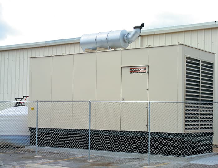

Mobile generator sets provide temporary relief.

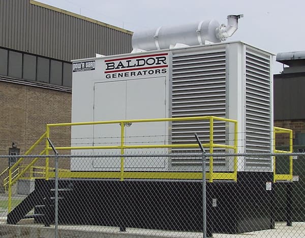

Diesel fuel tanks can be installed as a sub-base for generator sets.
