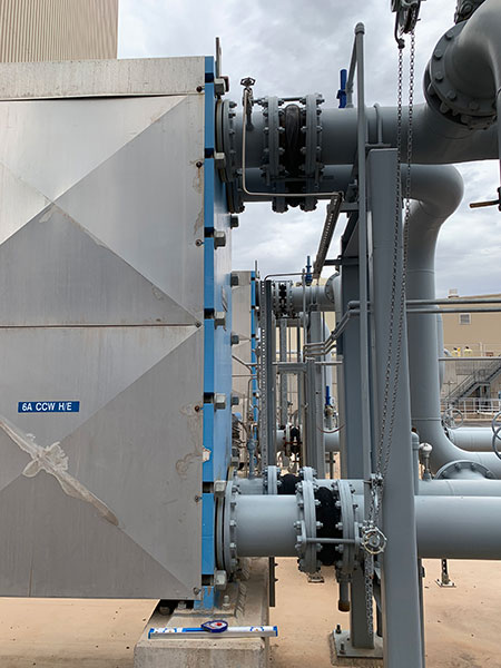

![Heat exchanger](/sites/default/files/10814/Image-3-6A-%26-6B-Closed-Cooling-Water-Heat-Exchanger-with-joints.jpg)
- cooling water circulation systems: supply and return lines, inlet and discharge of pumps
- heat exchanger systems: supply and return lines
