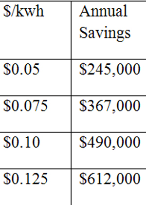

Reducing the wear ring clearance to 50 percent of the API standard will save a plant a substantial amount of money. Consider a population of pumps with total online horsepower of 25,000 horsepower—typical for a 100,000-barrels-per-day refinery. A 3 percent efficiency gain over the entire pump population will decrease power usage by 4.9 million kilowatt hours. Annual savings will be a function of the local cost of power (Table 2).
These savings do not include local incentives for reducing power consumption or other savings, such as avoiding the need for a new substation.
Table 2. Annual Savings from 3 percent efficiency gain on 25, 000 horsepower of pumping capacity
