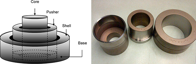

Compression packing is braided in a long rope spooled on a packing reel that is sold by weight or length. In the final stages, these ropes are converted into packing rings that are inserted into the annular equipment seal cavity, or the stuffing box. The packing ring is identified by size (ID x OD x thickness). The user can choose among three common processes in forming packing rings:- Cutting a length from the spool and then forming the rope with a set of molding dies

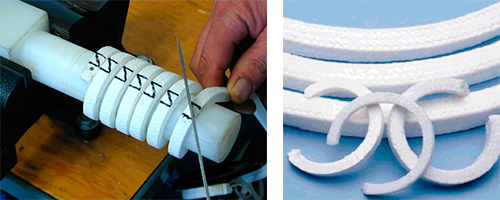

- Wrapping the packing rope over a mandrel that is the same diameter as the equipment spindle or stem and cutting the rings

Preformed braided packing rings are much easier to install and handle than field-cut packing rings. Most packing suppliers do not recommend field cutting unless the user insists on cutting their own rings or the customer is making emergency on-site repairs. Chances are high that field-cut rings—no matter the experience level of the technician—will have inconsistent ring lengths and edges, both of which are root causes of packing failure. If buckling or excessive leakage leads to a premature packing failure from a field-cut ring, a performance warranty may not apply.
Other advantages of using preformed braided packing rings include:
Figure 1. Packing molding die set

Image 1. Mandrel-cut packing ring

Easy to install and maintain, die-molded braided compression packing rings are the best option for applications in valves or pumps. Installing die-molded packing is similar to installing a cartridge mechanical seal. Both require fewer steps than packing cut from a spool by the user. Die-molded rings also eliminate many of the problems from improper ring fit. Die-molded braided compression packing rings follow two manufacturing methods:- An automatic molding process couples a molding hydraulic press to an automatic feed mechanism. The feed pulls the packing rope and cuts it to a predetermined length. These lengths are then inserted into the mold cavity and compressed into rings using a punch and collar die system. The upper and lower die punches are sized with the same dimension as the packing ring’s inside diameter, and the collar is sized with the same dimension as the ring’s outside diameter.
- A hand die set forms high-precision rings, usually for a low-volume operation. In this process, the packing rope is cut to size—on a miter blade jig, guillotine cutter or with a packing knife—and hand inserted into a die set. The assembly is then loaded into a hydraulic press and compressed at the appropriate level to form the rings.
Image 2. Die-molded braided packing rings
