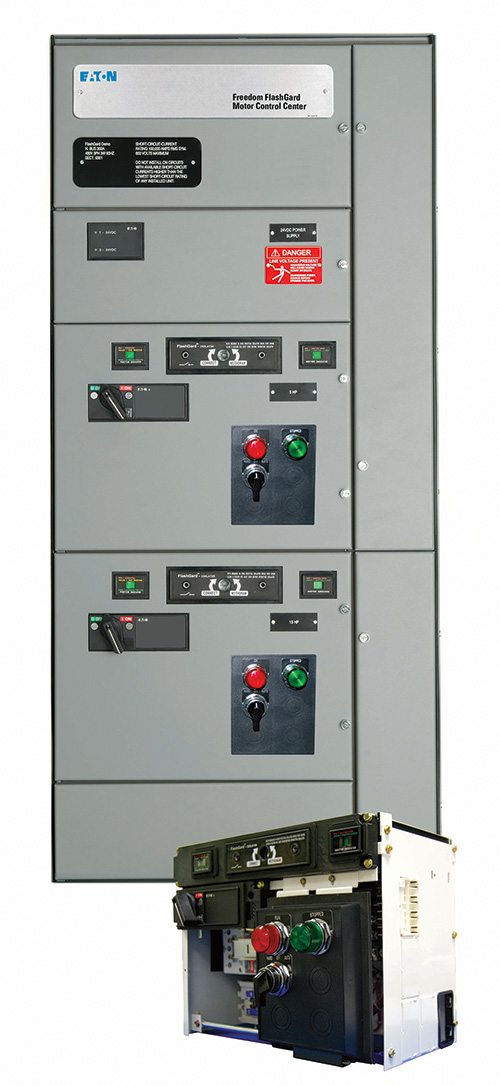

An arc-flash-preventive MCC provides technology to enhance personnel safety and protect equipment.

The main cause of arc flash incidents in MCCs occurs when an operator plugs in or removes a unit from a live bus with the unit door open. Arc-flash-preventive designs incorporate three key strategies to maximize the safety of equipment and the operator:
  • Prevention of arc flash events through the insulation and isolation of assembly elements prone to incidental occurrences during maintenance
  • A design that allows units to be disconnected and reconnected from the vertical bus with the door closed
  • Minimized operator exposure to dangerous events
Prevention is the foundation of arc flash safety, closed-door operation and safety interlocks. Arc-flash-preventive MCCs reduce the likelihood of arcing phase-to-phase and phase-to-ground short circuits by using insulated horizontal and labyrinth vertical bus. Additionally, active interlocks prevent the insertion or withdrawal of the MCC bucket while the stabs are engaged or extended. The MCC cabinet also incorporates two independent shutter mechanisms to automatically isolate both the vertical bus and unit power stabs when the unit is withdrawn.
For personnel, the cabinet is the main defense. MCC designs should incorporate substantial steel panels with doors that can be securely latched to suppress the effects of an arc flash, providing a barrier between a flash and the operator.

Beyond the basic arc-preventive-MCC designs, a range of equipment features and accessories can help further reduce the risks of arc flash events and enhance personnel safety. Fundamentally, closed-door operation, putting increased distance between the operator and the front of the MCC, and additional visual indicators can further advance safety. MCC panel accessories include modules that provide a visual queue for personnel. These modules typically flash when dangerous voltage is present inside the unit.
Mechanisms are available that enable the unit to be disconnected from the vertical bus with the cabinet door closed. Visual indicators on these mechanisms allow for quick, positive verification of the stab position, so operators know if the stabs are retracted or extended. An additional visual indicator provides verification of the MCC bucket’s safety status by indicating whether the internal isolation shutters are open or closed.
