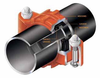

The elements of a grooved pipe joint
The mechanical joint, or coupling, is comprised of four elements: grooved pipe, a gasket, coupling housings, and nuts and bolts. The pipe groove is made by cold forming or machining a groove in the pipe end. A gasket enclosed in coupling housings is wrapped around the two pipe ends, and the key section of the coupling housing engages the groove in the pipe. The bolts and nuts are tightened with a socket wrench or impact wrench to hold the housings together. In the installed state, the coupling housings encase the gasket and engage the groove around the circumference of the pipe to create a leak-tight seal in a self-restrained pipe joint.
Like a flex connector, the coupling reduces vibration and noise transmission while handling deflection. The elastomeric gasket creates a discontinuity similar to that of a flex connector, while the design of a flexible coupling allows the joint to accommodate up to 5 deg of deflection.

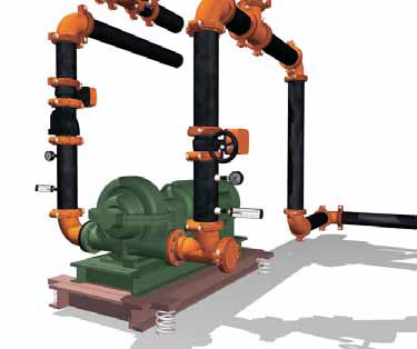

3-D model of a pump with flexible couplings
The design of the coupling is different from a flex connector. The coupling's housings hold the gasket in compression to create a seal against the pipe, while providing both space for the elastomeric material to flex, and containment to prevent overstretching. Full metallic containment is provided. Couplings maintain noise and vibration attenuation qualities, as well as the ability to accommodate deflection, expansion and contraction, throughout the piping system's life.
The gasket material attenuates vibration as well as noise transference, and the ductile iron housings provide vibration-dampening qualities due to the materials' inherent dampening coefficient. In fact, testing conducted by SSA Acoustics in Seattle showed that three couplings placed in series in a pipe section dampened overall vibration amplitude by 80 to 90 percent, with each successive joint creating a further reduction in vibration.
