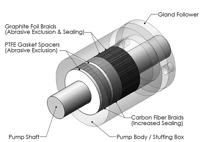

Gasket Spacers & Packing
Different materials and forms of material can be combined to create abrasive-resistant compression packaging for a variety of applications. For example, pure PTFE packing is required in chocolate processing to meet U.S. Food and Drug Administration cleanliness standards.
However, it is not well-suited to abrasive service. This problem can be resolved by using PTFE-braided packing in conjunction with one or two spacers made from PTFE gasket material.
The spacers are cut to fit tightly against the shaft and the wall of the stuffing box, creating a dam that excludes abrasives from the media. Placing one of these spacers at the bottom of the stuffing box and another between the packing rings can produce a marked improvement in performance.
Incorporating gasket spacers is proven to extend packing life. In pulp and paper digesters, for example, this practice has increased the packing life from four months to more than a year, according to industry sources. As a result, some manufacturers offer packing sets engineered to meet specific application requirements. These sets are typically supplied pre-cut and packaged sequentially for installation with no additional cutting or measurements needed. Figure 1 shows a packing set incorporating gasket spacers, carbon fiber yarns and graphite packing.

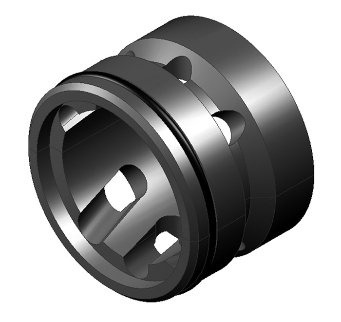

One of the best ways to reduce the volume of flush water is simply to use it more efficiently. Installation of an engineered bushing can mitigate abrasive wear and flush usage. With their tighter tolerances and flow control, engineered bushings significantly reduce the volume of flush media with performance equal or superior to standard lantern rings.
Bushings for more economical use of flush media are available in many materials but most commonly as engineered PTFE blends. Graphite-impregnated PTFE is a popular choice (see Figure 2).
This design prevents the entry of abrasives into the stuffing box by sealing the outside diameter of the bushing with a standard O-ring and flushing the shaft in a controlled manner. It is designed to replace a traditional lantern ring, which has more open clearances and allows less focused media flow, with the potential for more abrasives to enter the packing set. This is especially true of standard lantern rings in applications in which the pressure or volume of flush fluid fluctuates.
A standard lantern ring relies solely on the higher pressure of the flush water to exclude abrasives. In Figure 2, the fluted channels in the inside diameter of the bushing move the water in a spiral pattern, matching the clockwise or counter-clockwise rotation of the shaft. This movement produces a media flow fully covering the shaft and minimizing the entry points for abrasive material. The fluted channels also help conserve water by limiting the volume of flush water. This feature, coupled with the fact that the clearance around the shaft is much tighter than a standard lantern ring (approximately 0.012-inch vs. 0.063-inch), results in much less water usage and better abrasive protection for the packing set.

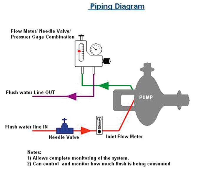

To quantify this reduction in water usage, a simple, low-cost flow meter can be installed on the flush port of a pump to obtain a baseline against which to measure conservation gains. After the lantern ring packing set has been replaced with a new bushing and packing set, another measurement can be made for comparison to the baseline. In many cases, an immediate improvement will be noticed. Moreover, the fluted bushing and engineered packing set will likely allow the flush flow rate to be lowered, while still providing superior protection.
Figure 3 shows a typical flow meter application using an engineered packing set. In this case, the use of two flow meters and a control valve on the incoming line provides the most detailed information. By capturing the rates of inward and outward flow, highly accurate measurement of the volume of water entering the process stream is possible. This requires two flush ports, which on some pumps may call for modification of the existing stuffing box. A number of industries use this piping design to track flush media usage in real time and accurately calculate costs associated with the flushing process. Annual savings in the tens of thousands of dollars have been documented by facilities adopting this approach.
