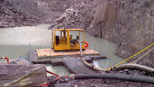

pps
Image 1. The pumpset for this application uses a 150-millimeter (6-inch) centrifugal pump powered by a 224-kilowatt (190-horsepower) diesel engine. It is capable of a maximum flow rate of 525 cubic meters per hour (139,000 gallons per hour).

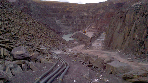

packaged quarry solution
The new packaged quarry solution

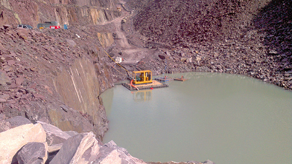

new solution
The new solution for quarry dewatering

With the efficiencies of the proposed alternatives being comparable, the quarry operator’s decision was predicated on pumping capacity. After evaluating both options, the company selected the 150-millimeter pumpset (see Image 1). The company decided that the larger of the two alternatives was not necessary for its current operating levels. Even so, the lower capacity option greatly reduced monthly rental costs compared to what they had been for the old diesel-submersible system while also reducing fuel costs considerably.

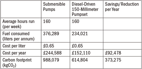

Table 1
Table 1. Comparison of the previous pump system used at the quarry with the new solution

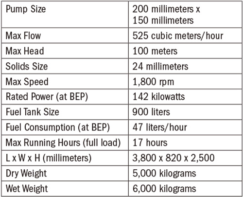

Table 2
Table 2. Pump specifications
Table 1 compares the previous solution, using submersible pumps, with the new solution. The improved performance of the 150-millimeter option resulted in a reduction of approximately 30 percent in consumed fuel, at an estimated annual savings of £92,000 ($141,000 U.S.). The solution also reduced the carbon footprint by 373 tonnes (411 tons, U.S.) per year. Additionally, by employing the single-pump solution and contracting with the pump solution provider for ongoing service and support, the inevitable downtime problem that the quarry operators experienced was eliminated. P&S
