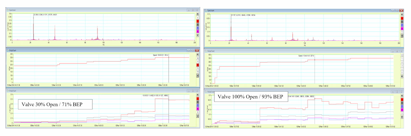

5. Trending Over Time While Measuring Other Parameters
The cause of the high vibration can be related to system operation, such as speed of rotation, flow rate, submergence, net positive suction head available and inadequate intake/piping design that is exacerbated at certain conditions. This can result in the high vibration only occurring or getting worse during certain system conditions. To screen for this, continually logging all relevant data for a sufficient period is required. The screening period depends on the system and how it varies naturally or how easily it can be manually adjusted to cover the desired variation. This also requires the ability to log data simultaneously or with accurate time stamps so it can be matched up during the analysis. Typical system operation related faults that can be detected are as follows: operating at too low a flow rate and resonance.
Image 3 provides two trends for the same pump, showing vibration logged at multiple locations as a function of speed. The left figure is a lower flow rate (71% of the best efficiency point [BEP] flow rate), and the right figure is for a higher flow rate (93% of BEP). What can be noted is the vane pass vibration (3x) is the main contributor to the overall vibration; near the maximum speed of 330 to 350 rpm, the overall vibration is highest, and the vibration is nearly double at the lower flow rate. This does not provide the analyst with a clear picture of the cause, but it does provide important information that can be further evaluated. For example, there could be a resonance occurring at the vane pass frequency, and it is evident the vane pass force is greater at the lower flow condition.
