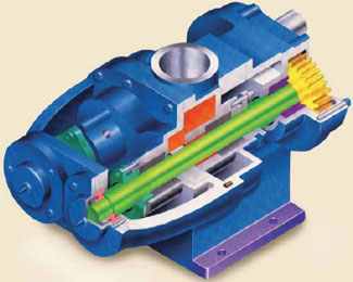

Figure 1. Typical internatl gear pump used in the facility.
When building its Gordon, GA plant, Alterra Bioenergy sought pumps that would produce relatively constant flow, independent of viscosity changes and resulting variations in line losses. Some of the plant is located outdoors and unheated, and the ambient temperature may range from 0- to 100-deg F. The viscosity of vegetable oil will correspondingly range from about 125 centistokes at 0-deg F to 25 centistokes at 100-deg F. Variations in line losses can approach 50 percent over this range of viscosity.
Internal gear pumps were selected for the plant because the pumps could meet the requirement of constant flow delivery over the anticipated viscosity and line loss variations, and pumps were supplied within the time window necessary to support the schedule of bringing the plant into production. With a chilly winter season, the pumps had been tested on-and passed-the constant delivery requirement. Figure 1 (above) is a cutaway view of a typical pump used at the facility.
