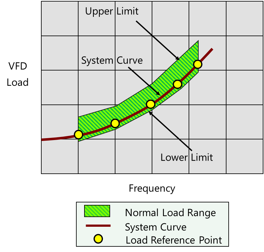

Often, a VFD alarm is not an indication of a VFD problem but rather an issue with the motor, pump or valve. It can be difficult to identify the root cause, as it is a human tendency to blame the messenger or, in this case, the VFD. Modern VFDs have methods to better pinpoint the root cause of the issue. A user can now configure a normal operational range by defining a system curve, upper limits and lower limits. The drive can also learn the pump system’s normal operational range and automatically populate system curve points and limits. If the system performs outside of the defined operational range, the drive will either generate an alert to warn operators or a fault to shut down the drive.
For instance, if the pump coupling breaks, the drive would generate a load warning or fault, notifying the operator of the issue. Likewise, if a pump bearing is damaged, additional torque would be required to operate the pump. This additional torque requirement would cause the VFD to operate outside of the established operational range. The abnormal load warning or fault alerts the operator to an abnormal condition, identified by the VFD but originating in the mechanical system.

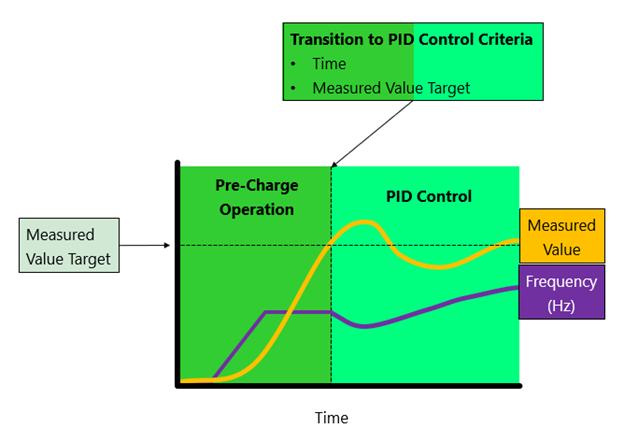

Modern VFDs can be instrumental in preventing dry-running pumps and damage to mechanical seals and bearings. Advanced PID functionality can ramp a drive up to a preset frequency to pressurize the discharge header before transitioning to PID control, eliminating pressure fluctuations.
