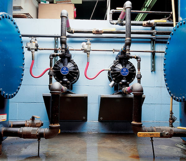

air-operated double-diaphragm pumpsImage 1. Chemical transfer with air-operated double-diaphragm pumps (Images and graphics courtesy of Graco Inc.)
1. Check the inlet air line size and pressure.
Installing an air line that is too small is the most common mistake users make when installing an AODD pump. Using too small of an air line will starve the pump of the fuel—compressed air—it needs to operate at peak performance. Upgrading to a larger air line is an easy fix that takes a few minutes.
Double-diaphragm pumps come in all shapes and sizes, based on the application and fluid requirements. Larger AODD pumps (1-inch and greater) require more compressed air and larger air lines than smaller pumps to operate at full capacity.
The appropriate air line size for a pump is located in the manufacturer’s installation and operation manual. As a general guideline for AODD inlet air line sizes, match the air line hose size to the air inlet port size on the
air valve.
Inlet air pressure also plays a key role in getting the most out of a pump. Diaphragm pumps operate on a 1-to-1 ratio, meaning the pressure of the inlet air feeding the pump is directly related to the fluid pressure at the pump’s outlet. For example, if the target outlet pressure of a 1-inch, 50-gallon-per-minute (gpm) pump is 100 pounds per square inch (psi), the inlet air pressure entering the pump’s air valve must be greater than or equal to 100 psi.
System backpressure and fluid viscosity will impact the outlet fluid pressure. Too little backpressure may cause the pump to run inefficiently because the ball checks may not check as quickly. Too much backpressure can cause the pump to stall if the fluid pressure overcomes the air pressure to the pump.
To control the performance (flow and pressure) of an AODD pump, install an air regulator assembly to control the incoming air pressure (see Figure 1, C). Installing the correct air line size with an air regulator will solve the most common AODD pump installation problem.
