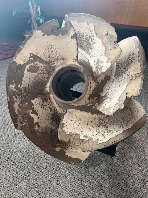

IMAGE 3: Damaged impeller removed from Pump 5 currently on display in SMMWSC’s board room
However, in recent years, the operators and maintenance staff noticed the performance of Pump 5 had decreased. By 2021, the output of the pump had dropped by approximately 5 to 7 mgd, which prompted concerns among SMMWSC’s staff. Between the combination of Pump 5 being last rebuilt in 2003 and an inspection by a diver in 2021 observing erosion and material loss in the bottom stage impeller vanes, it became obvious Pump 5 needed to be rebuilt to restore the pump’s efficiency and reliability.

SMMWSC’s management and board decided to rebuild Pump 5 in response to the observed drop in the pump’s efficiency and performance. The pump was removed and sent to a reputable pump repair facility for a complete disassembly, inspection, and ultimately, repairs. The pump repair facility’s inspection report highlighted several critical issues with the pump, including bearing clearances being out of spec in the suction bowl, each bowl series, the column and the stuffing box. In addition, the impellers exhibited significant material loss and had formed cracks up the impeller vanes. It is suspected the impeller’s material loss was accelerated due to dezincification since impellers were cast from silicone bronze and were being used to pump chlorinated water. Ultimately, the report concluded the damage to the impellers was beyond repair, and the impellers would need to be replaced.

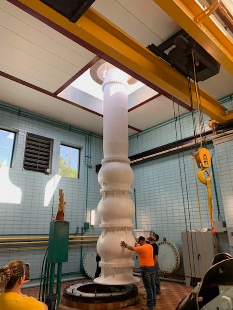

Pump 5 being reinstalled at the Whitestone Pump Station
IMAGE 4: Pump 5 being reinstalled at the Whitestone Pump Station

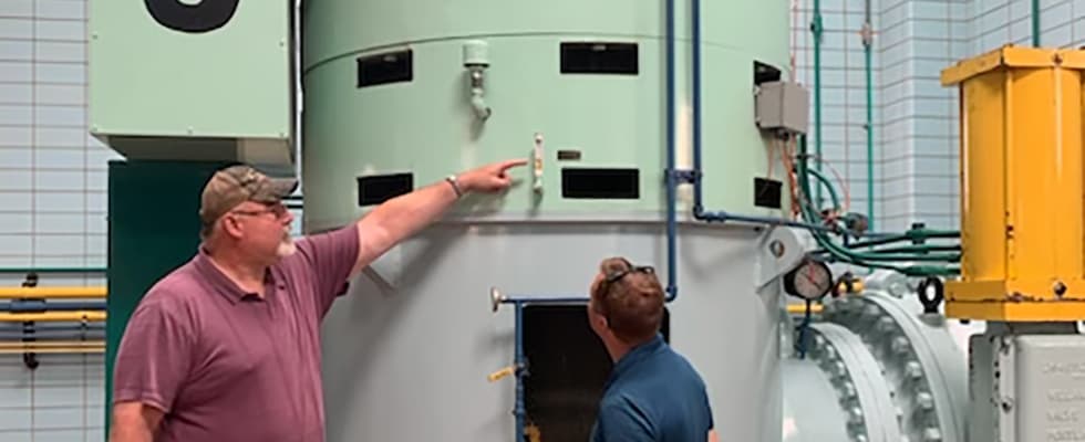

 SMMWSC’s general manager, Dan Stickel, and Operations Manager Tom McLavy inspecting Pump 5 after its reinstallation
IMAGE 5: SMMWSC’s general manager, Dan Stickel, and Operations Manager Tom McLavy inspecting Pump 5 after its reinstallation
