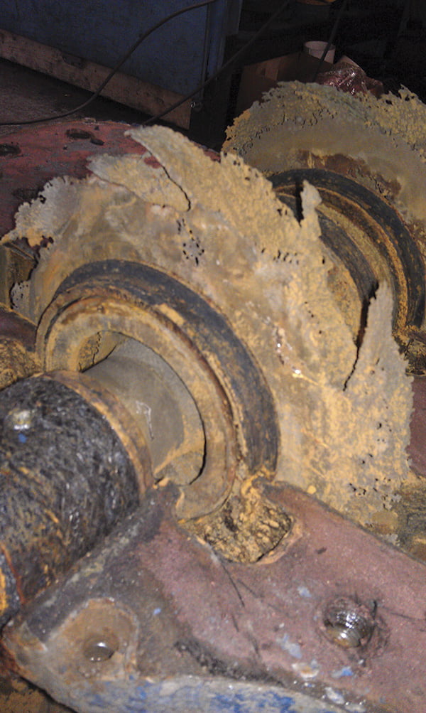

A refinery in Northwest Indiana is home to an internal power plant, which includes three high-pressure service water pumps. These pumps provide cooling water to the bearings for the forced-draft fans on top of the boiler house. They also cool two other pieces of equipment throughout the power plant. The pumps are 1947 vintage Ingersoll-Rand, 3BEV, two-stage horizontally split pumps (see Image 1). Packing is used for sealing instead of mechanical seals. In addition, the pumps use greased bearings and are designed to provide a flow of 500 gallons per minute (gpm) at 250 feet of total dynamic head (TDH). The pumps have been reliable with low vibrations. The main maintenance tasks are monitoring and replacing the packing and changing the bearings in the field.

Option One
The first option to consider was the purchase of a new pump. How much would a new, in-kind pump cost? The thinking was, if the price of a new pump were comparable to the repair, a business argument could be made for the purchase. Unfortunately, the cost of a new pump was more than twice the predicted cost of a repair.Option Two
The second option was to reverse engineer the pump case at a third-party facility. However, the pump would still have the obsolete design with packing unless additional engineering was carried out. The additional engineering would add cost and lead time. The drawback of this option was the high cost of reverse engineering and the need to pull the pump for the duration of the project (reverse engineering, casting, manufacturing, assembly and testing). This choice was not ideal but seemed more feasible than the first option or the repair option.Option Three
The third option considered was to evaluate several original equipment manufacturers' (OEM) product lines for a modern design pump that meets the hydraulic requirements and motor horsepower. Many were available in different designs that met these requirements and that provided metallurgy and design upgrades that were in line with the cost of the repair option. However, this change required foundation and piping modification which would add to the overall cost. This third option was considered acceptable in spite of its expanded scope and higher cost because of the advantages these upgrades provide.Option Four
While these options were being considered, another project was in the works at one of the refinery's cooling towers, which became the fourth option for this project. This option was discovered by chance. A fellow pump engineer was working with a company that reverse engineers impellers. For that specific application the refinery needed several impellers in a short period of time, and all the traditional avenues (OEM or reverse engineering) could not meet the deadline. Based on the positive experience of another engineer dealing with a similar challenge, he recommended contacting Sims Pump Company (Sims). This company reverse engineers impellers like other companies. However, it uses its own material, which is Simsite. The material is a graphite-combination-fiber, continuously interwoven, reinforced composite with phenolic/epoxy thermoset resin. The company was able to reverse engineer these impellers faster than any of the other options. The material offered its own advantages that included corrosion resistance and light weight. During the discussions about the impellers, the unit's team wanted to learn more about the capabilities of reverse engineering and manufacturing pump casings using this material. The sales person provided the engineering team with information including the curve, outline drawing and service conditions for review. During these discussions and with full understanding of this new approach, the unit team had to agree on a list of requirements, goals and potential drawbacks. Based on these discussions, the refinery's power plant team developed the following list:- Meet the same hydraulic specifications.
