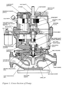

The pump is a 300-hp integrally geared propylene product pump in a Gulf Coast olefins unit that operates at 25,000-rpm and produces 6000-ft of head (see Figures 1 and 2). The suction and discharge pressures of the pump are 250-psig and 1500-psig, respectively.
