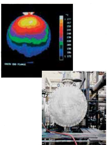

Improving flange reliability requires the understanding of why the bolted connection failed. Critical and difficult flange applications at a plant often need a more detailed understanding and analysis of the flanged joint. Heat exchangers are often critical problematic applications due to thermal variations and hydrostatic pressures. See Figure 1. An engineered flange sealing system takes into consideration proper gasket sealing stress and optimized bolt loading.
Typical heat exchanger
Figure 1. Typical Heat Exchanger

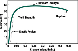

Gaskets perform the sealing in flanges, but the flange bolts provide the gasket stress necessary to achieve an effective seal. A bolt is an elastic element. When it is tightened it will stretch. When the bolt is stretched in its elastic region it will retain its memory. As a result, when the bolt is stretched it will exert a force on the flange and the gasket as it tries to get back to its original length. The more you stretch it in its elastic region, the higher the bolt force transferred to the flange. The stretch of the bolt is limited by the yield strength. It is important that the bolt stress is within its elastic limits. If the bolt is stressed beyond its yield point, it will no longer provide the required elasticity for the flanged joint to seal reliably. See Figure 3.
Typical Elastic Curve for a Bolt
Figure 3. Typical Elastic Curve for a Bolt.
A correct and constant bolt load is essential to reach and maintain the proper compression of a gasket throughout its service life.

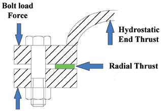

The seal is affected by the action of force on the gasket surface. Sufficient stress/load must remain on the gasket surface to prevent leakage. Hydrostatic end thrust works to open the flange joint and reduces gasket seating stress. See Figure 3. The bolt load force must be greater than the force created by system pressure to maintain the seating stress on the gasket above the minimum required to maintain a seal.
Hydrostatic End Thrust
Figure 4. Hydrostatic End Thrust.
Many problem flanges are subject to thermal expansion and contraction, pressure surges and vibration. These factors can either decrease or increase the bolt load and gasket stress from the initial installed values, which can lead to premature leakage and failure of bolted assemblies. Flanges can be a dynamic component and often require a dynamic sealing solution to be properly sealed.
