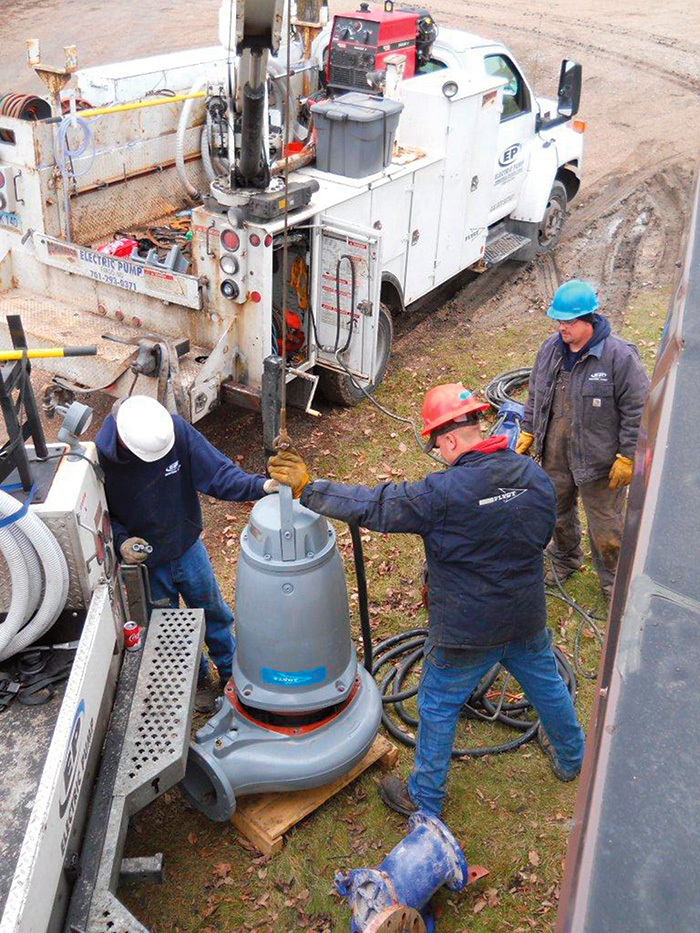

A three-man crew uncrates and prepares the new pump for installation after piping modifications.

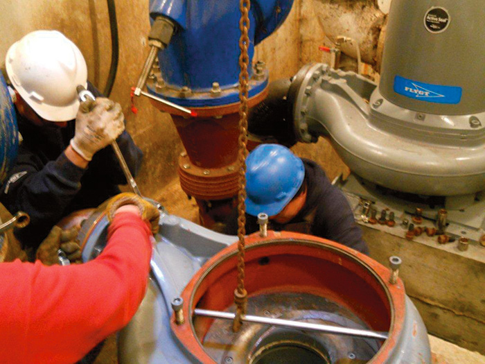

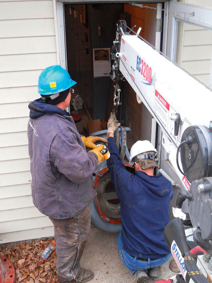

The crew maneuvers and lowers the volute for the replacement pump through the side door into the station.

Workers place and secure the volute before the remainder of the pump is received.
