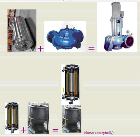

 Submerssible Motor Setup
Submersible Motor Setup

Sump pump or dry pit (close proximity or U-jointed) options keep the motor far from the pump and protect against flood, but a long shaft imposes unbalance whip forces that can increase with time and reduce pump reliability. Submersible pumps (either wet or dry) solve the issue of the motor for awhile, but their windings are separated from the pumpage by a mechanical seal. If it fails, the pumpage can flood the windings and kill the motor. Another possible option is a submersible motor not directly coupled to the wet end, but with a regular coupling between it and the pump.
One of the benefits of retrofitting with a submersible motor is that the wet end (the pump) does not change. The regular motor (whether coupled in close proximity or separated by long, U-jointed shafting) is removed and replaced with a submersible motor. The shaft of the submersible motor is not directly attached to the pump impeller and is separated by the seal. The bearing housing of the pump is modified to have its shaft separately coupled to the motor shaft.
During normal operation, such a retrofitted installation operates normally as a dry or wet motor. In the event of flooding, even of the entire station, the submersible duty motor is not affected; it continues to operate as a regular submersible motor since it is designed to operate underwater.
Such a retrofit saves the millions required to construct a new station or remove it from a flood zone. At a minimum, it saves hundreds of thousands that would be needed to replace the entire pump with a new design and modify the piping to fit to the flanges of a new pump.
