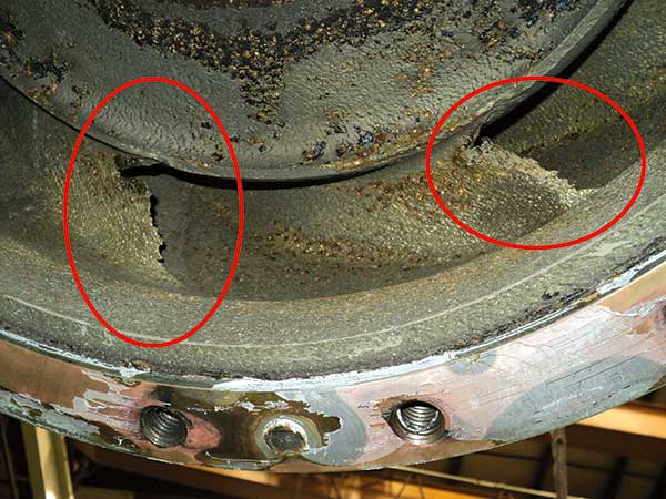

A single-stage, vertical pump in a service water application was sent for repair by a nuclear power plant to a qualified, independent pump service and engineering provider. A thorough inspection was performed. Although several important parts had to be reverse engineered and manufactured, all but one were machined parts for which raw material was available. One large cast part, a large aluminum bronze suction bowl weighing more than 500 pounds, was identified as the critical delivery issue.
Severely Eroded Suction Bowl
Severely eroded suction bowl
Photo courtesy of Hydro Inc.

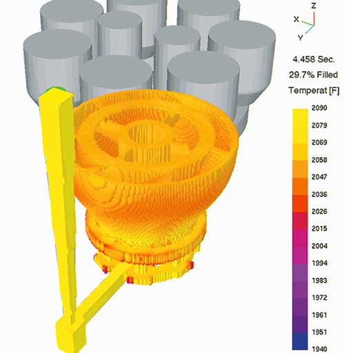

Once the 3-D model for the casting was complete, the service provider’s engineers worked with a reliable foundry known for producing excellent aluminum bronze castings to develop a manufacturing and quality plan to cast the replacement suction bowl. With a thorough understanding of the latest rapid casting processes, the engineering team created a casting plan that included a layout for the risers, gates, runners, sprue and other mold package details. This plan was engineered using solidification simulation software so the engineers could determine the optimal layout for the mold package. A well-designed mold package reduced the risk of a failed casting and maintained the rebuild schedule.
Solidification Simulation
Solidification simulation
Image courtesy of Hydro Parts Solutions Inc., a Hydro Company

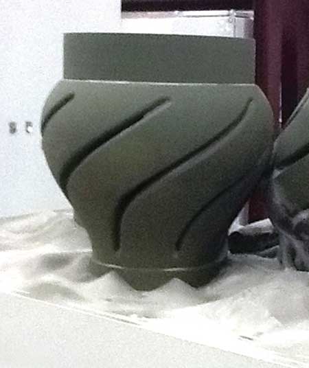

Once the casting plan was complete, the 3-D model was used to make a large, sand-printed mold package. The mold package consisted of several mold pieces and a large core for creating the intricate details within the bowl. This modern technology allowed the service provider to produce a successful casting in a timely manner without a hard pattern or core box.
Typical sand-printed core

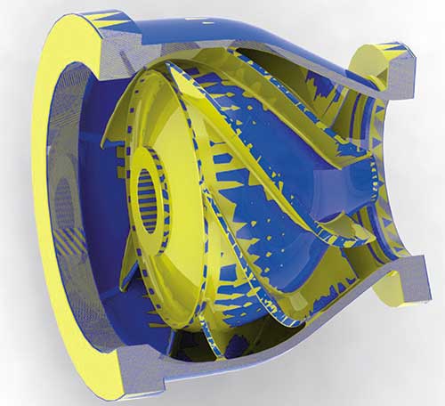

The service center’s engineering team proceeded with a part comparison to ensure equivalency. Using a CMM, a 3-D model was created with the cast part and overlaid onto the 3-D model of the reverse engineered suction bowl. In Figure 1, the yellow area shows the reverse engineered model. The blue area shows the cast bowl model. The overlapping surfaces of both models confirm the conformance of the geometry of the cast bowl to the geometry of the reverse engineered bowl.
Figure 1
Figure 1. Comparison of 3-D models
Image courtesy of Hydro Inc.
Any observed deviations from the geometry of the reverse engineered bowl were determined to be negligible and were far less than the deviations that typically occur in conventional castings. Furthermore, the critical hydraulic dimensions on every vane passage were confirmed to be correct and uniform to ensure hydraulic performance and operational stability.'

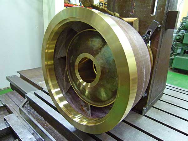

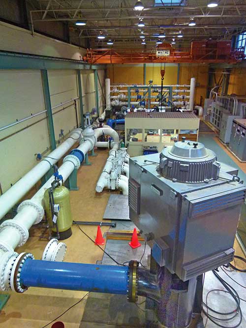

The suction bowl was finish machined, and after passing another inspection by the quality assurance team, the vertical pump was rebuilt using the proper assembly procedures. The completed pump was then performance tested at the service provider’s independent test lab. The test results confirmed that the pump performed with improved efficiency, and it proved the integrity of the reverse engineered part. The nuclear power plant accepted the certified test report and returned the vertical pump to safety-related service.
Bronze Suction Bowl
Bronze suction bowl on horizontal boring mill
Performance Test
Performance test for an Ingersoll Rand vertical service water pump
