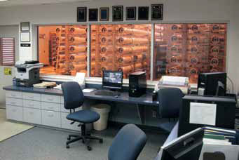

In late 1997, design of the facility that would include the RO systems commenced. A concrete block structure was conceived that would blend in with the architectural landscape of the village. Since a fair amount of noise was associated with the pumps that feed the membrane process, they were housed in a different room, creating a far more comfortable operating environment when maintenance on the membranes was required.

The facility was built to house a maximum of three 1.2 mgd RO trains, for a total capacity of 3.6 mgd. Currently there are two installed trains; the second one was commissioned in 2007. After the water is pumped from the newer, deeper water source, booster pumps increase the pressure to provide the proper operating pressure for pre-treatment with sulphuric acid to keep the pH low; the lower pH helps keep the hydrogen sulfide gas in the well water throughout the process. An anti-scalant is then added to prevent the formation of carbonates, after which the water travels through a pre-filter (one micron), before going to the high pressure pump, which increases the pressure to the RO membranes.
Once at high pressure, about 276 psi, the water is forced through the semi-permeable membranes to separate the impurities; the filtered water or permeate passes through the membrane and the concentrate is sent to waste and discharged. The permeate from the RO is pumped to the clear well, or finished water tank, where it is mixed with the 2.74 mgd of water drawn from the upper aquifer and goes through filtered systems; the entire mix is then treated via the older filtration process, then goes into a clear well.
The entire water treatment system is fully treated with chlorine and computer-driven; any out-of-range conditions are immediately communicated to plant operators for remediation or shutdown. This RO permeate is a high-quality water, more like a distilled water, which makes it an excellent complement to the older water source.
