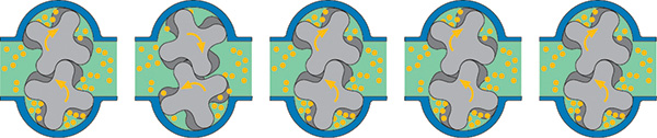

Rotary lobe pumps are part of the positive displacement group. They create flow by trapping liquid from the suction side, carrying it through the pump and expelling it out the discharge side. During operation, two rotors mesh together and rotate in opposite directions (see Figure 1). The rotation forms cavities between the rotors and wet-end housing. The liquid that fills the cavities is carried through the pump and expelled out the discharge side.
Rotary lobe pump operation
Figure 1. Rotary lobe pump operation

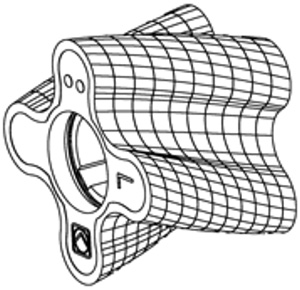

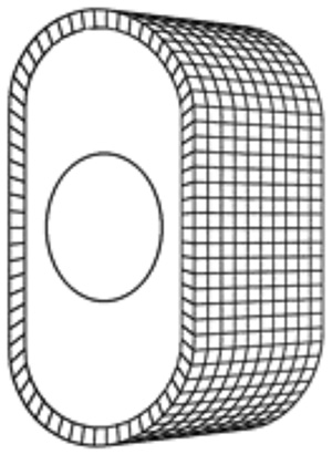

These pumps can have two basic types of rotors: straight and balanced. A straight rotor (see Figures 2 & 3) can have two, three or more lobes. They are straight from front to back and could be elastomer coated, solid metal or flame spray coated.

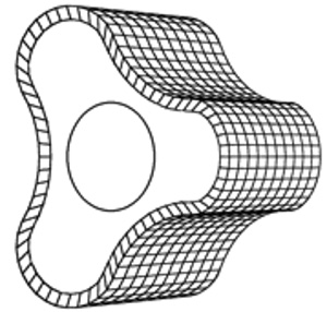

The second type is the balanced rotor (see Figure 4). A balanced rotor can have two, three or six lobes. This design is also available in elastomer-coated, solid metal or flame-spray-coated versions. A properly balanced rotor produces a smooth, steady flow of liquid that is free of pulsation. A properly balanced rotor is also much more difficult to design and machine than a straight lobe design.  If pulsation is a factor in the application, reviewing the performance characteristics of each brand is important.
