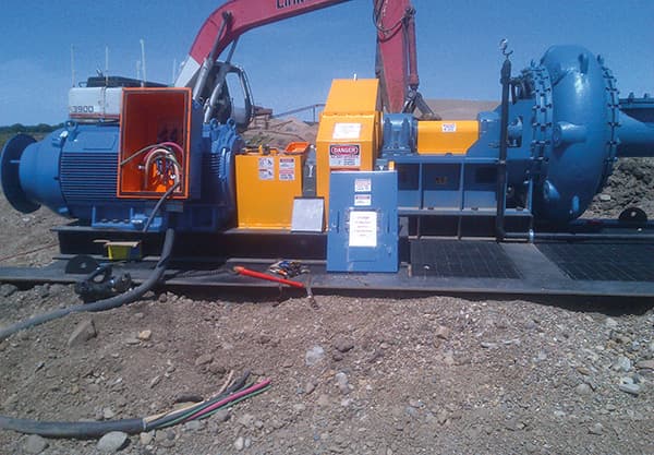

The plant’s engineering team determined that a solution might be to install a booster pump that would be placed between the primary pumping dredge and the processing plant. Since the maximum distance of the new mining areas was 2,500 feet from the existing processing plant, the booster pump would need to be sized to handle the heavy slurry material efficiently from that distance. It also had to be placed at least 1,000 to 1,200 feet from the existing processing plant between the plant and the existing dredge. A suitable peninsular area that had already been mined was chosen as a location for the booster pump and additional drive equipment. Also, all components needed to be completely contained and mounted on two movable skids.
After studying these criteria, the Hallet team determined that a booster pump using an 800-horsepower, alternating-current (AC) motor and variable speed drive would efficiently drive and control the slurry pump. Hallet Materials consulted an electric motor company for help. The key criteria for the new booster pumping station would be that it had to be efficient, electric and extremely quiet because of the close proximity of residential neighborhoods. The company’s latest version of its 800-horsepower motor was chosen because of its high reliability and low maintenance. In similar installations, this motor provided a wide speed range, low weight to output ratio, high capacity to dynamic loads and low noise level.
In addition to the booster pump, the electric motor company provided a medium-voltage drive, power transformer and harmonic filter, which were needed for the installation to be matched for optimum efficiency. All this equipment was mounted on a separate skid, allowing it to be located on the peninsula along with the pump skid.
After determining the specifications of all the equipment required, the company designed and constructed custom cabinets and enclosures to house these additional components and mounted them on the second skid. Matching all these components was critical in achieving the highest efficiency output and lowest electrical usage. The medium-voltage drive was selected because of its modular design and its 99 percent efficiency record in many similar applications.
The 800-horsepower, AC motor and slurry pump were assembled on a custom skid, allowing for an extended mining area.
