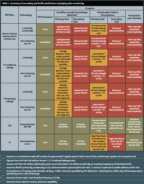

Table 1 compares typical containment seals against other typical dual seal arrangements (see page 36). Various typical scenarios are presented along with the alarm strategy that would be used and the effect of the condition. The traffic light color coding illustrates areas of concern. In particular, Table 1 focuses on a major event where the seal leakage is high (so-called catastrophic). Generally of equal importance is the prolonged integrity of the secondary sealing device since this ultimately prevents or restricts the leakage of large amounts of process fluid into the atmosphere. In the case of containment seals, the condition of the secondary seal at the time of the primary seal’s failure—along with monitoring devices—will dictate how long containment is likely to last (if at all) and hence whether process leakage will be prevented prior to shutdown and isolation of the equipment. Kalfrin and Gonzalez2 recommend protocols: testing containment seal integrity to detect a potential hidden failure of the outer seal. It is recommended to establish and adjust testing frequencies. Fone and Bowden3 recommended containment seal integrity testing to be conducted on a weekly basis—such frequency would probably be impractical, however, as with any spot check testing the condition of the containment seal is only known at the point of testing.Conclusion
Secondary containment seals should be operated with particular attention to control the normal primary seal process leakage collection. Operating them with an appropriate API plan as stated in API 682 is always key to ensure safe collection or disposal of the primary seal process leakage. In the example case study shown, the ideal solution would be to upgrade the seal and seal support system to a dual seal with a pressurized seal support system, which would ensure the integrity of both the primary and secondary seal.- For the purpose of clarity we have used the American Petroleum Industry standard API 682 4th Edition definition of a containment seal i.e. ‘Containment Seal – Special version of an outer seal used in Arrangement 2 and that normally operates in a vapor (gas buffer or no buffer) but will seal the process fluid for a limited time in the event of an inner seal failure’
