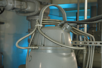

A vibration sensor on a pump in a water application.

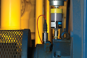

The industry standard for sensors with separate cables and connectors is to use a 2-pin MIL style connector. This rugged connector is threaded with an internal keyway and hermetically sealed onto the accelerometer. When paired with the right cable connector, these sensors work well in outdoor applications where they will be subjected to the elements.

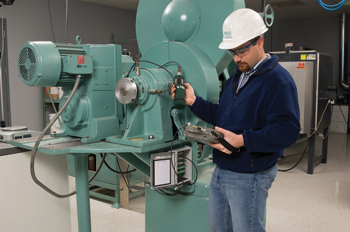

Portable handheld calibrators are a popular marketplace tool. These devices allow the user to perform a quick calibration check of the accelerometer to ensure the industrial accelerometer's sensitivity is still within specification. The calibrator vibrates at a fixed level and frequency with the sensor mounted on top.

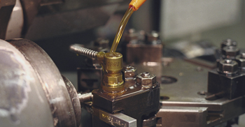

An integral armor cable accelerometer in oil.

The cable's jacket is the most critical aspect in cable selection. Polyurethane cables are the easiest to work with as they have the tightest bend radius and are the most flexible. They are submersible and excellent for outdoor use. Teflon cables are recommended for high temp or caustic applications. Armor jacketed cables are commonly used in cutting-tool applications or any scenario where the cable can easily be cut or damaged.

A handheld calibrator, plus a data collector and sensor.
A sensor with separate cable and connector mounted on a machine.
