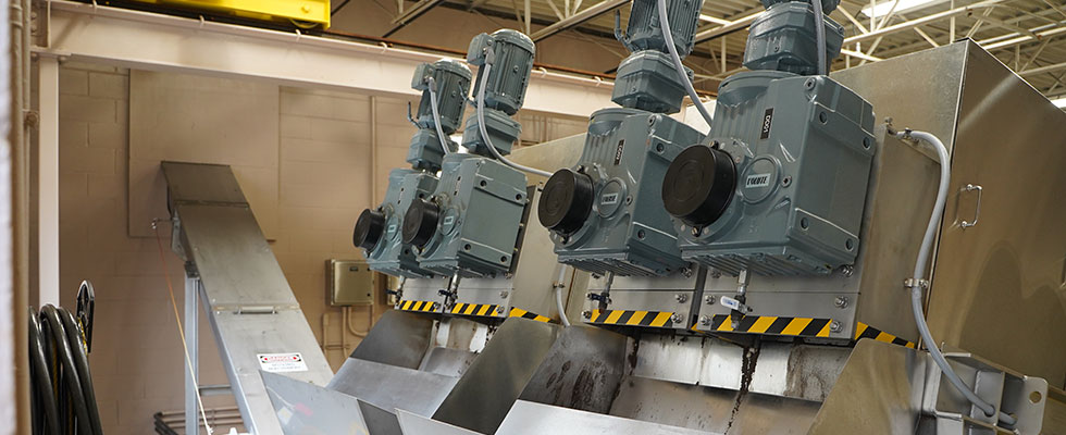

After examining Bentonville’s needs, it was suggested that two screw press systems were needed for a pilot test: a traditional design screw press and a more modernized version that employs a dewatering drum. The modernized screw press design (sludge dewatering press) achieves thickening and pressing in one compact operation.
In Bentonville’s pilot tests, both screw presses performed well. However, the traditional press required a greater investment in infrastructure and installation ($9.1 million) compared to the sludge dewatering press, which better fit the belt filter press’s existing footprint and required minimal construction and installation costs ($1.1 million).
The city of Bentonville installed the sludge dewatering press in two months with little to no construction or installation challenges. The city completed the system and started service in January 2019.
The Results: A Piece of Cake
Bentonville was attracted to the design of the sludge dewatering press. The key feature is a drum design, which thickens and presses sludge in one compact operation. The design is an efficient means of dewatering, transforming feed sludge as low as 0.1% into cake, often over 20% solids. The efficiency has already created savings for Bentonville. The new screw press only requires nine days of usage per month (12 hours per day) compared to the old belt press, which required 22 days per month.
Additionally, to evaluate the effectiveness of the sludge dewatering press, Earl compared the average solids produced between the final year of the belt press and the first year of the volute dewatering press. In its final year, the belt press produced an average of 13.25% daily solids. In its first year, the volute dewatering press produced an average of 18.66% daily solids for a 28.5% increase in solids.
The new screw press translates to a dryer cake, which offers a benefit for disposal. The dryer cake means Bentonville is paying less to haul a greater percentage of solids. Earl also notes that currently, after fine-tuning the new machine, the city now produces 22% solids. Also, in its first several years of usage, the sludge dewatering press has required only minimal preventative maintenance.
“We’ve only needed to change the oil in the gear boxes and grease the things that need to be greased,” Earl said.
For the city, the benefits translate to more clean water in the environment and cost savings.
Finally, since installing the sludge dewatering press, Earl has enjoyed the pristine nature of the fully enclosed stainless-steel unit.
“Anybody who has ever dealt with a belt press knows there is always a mist in the air, a water in the air,” Earl said. “With this new machine, none of that is happening. It is so clean out there, you can almost eat off the floor.”
