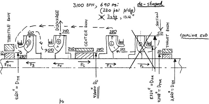

Consider, for example, a case of reliability problems in a multistage, horizontally-split centrifugal pump in service at a pipeline booster station. This pump had been de-staged from the original, four-stage opposite impeller design, to a three-stage modification. Originally, the pump service was for lower flow and pressure. To match a new set of operating conditions (3,100 barrels of gasoline per hour, at 690-psi pump developed pressure) the first stage of this pump was replaced with a blank pass-through spool.
In the case described above, the pump rotor seized, on average, nearly once per year, resulting in poor reliability, increased repair costs and lost production. Upon inspection, a low suction pressure zone was found, which resulted in periodic flashing of the product, causing cavitation, which affected the side of the bushing adjacent to this low pressure zone, as evidenced by the pitting that was found on the rotor and bushing area. Flashing of product in that area resulted in a loss of the needed lubricating film of liquid within the clearance of the bushing. This lack of lubrication liquid also contributed to the rotor seizure at the bushing area.
Figure 1 illustrates the flow of product through the pump, indicating pressure increase from one stage to another, as well as showing the orientation of the internal bushings with their clearance separating internal regions of pressure from each others.
Figure 1. Product flow through the pump
Four main types of clearances are:
• Throat bushing, which separates the suction (inlet) pressure (50 psig) from the mechanical seal cavity (to the right of the illustration, not shown in Figure 1). Since the seal area is immediately adjacent to the suction area, it is under the same pressure as suction.
• Center bushing, which separates the intermediate-pressure from the high-pressure zones. This pressure differential has increased due to the de-staging, making this a more important leakage path.
• Throttle bushing, which separates the intermediate pressure from the suction pressure (the area to the left of the illustration, past the throttle bushing, is connected to the suction area via a balance line).
• Impeller-to-case wear rings. Typically, there is one stage pressure across these rings.
• Hub wear rings. Typically a minimum flow area with little differential pressure. This pump has only one such clearance between stages 3 and 4.
