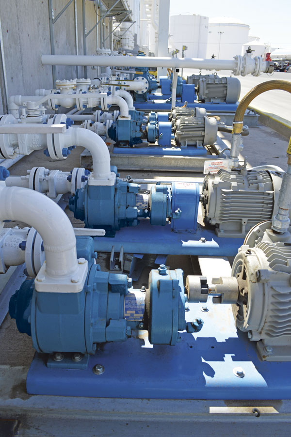

The Middle East and North Africa are home to one of the world's most sophisticated storage-terminal networks for refined petroleum products. The market is ripe for significant investment and expansion. Millions of cubic meters (m3 ) of independent tank storage will be made available in the region to support advanced recovery efforts among the region's maturing oil fields. For example, the UAE plans to double its tank capacity during the coming years. The Port of Fujairah recently expanded its storage capacity to 8.67 million m3 with plans to expand to about 12 million m3 by 2017. This expansion will give Fujairah the world's second-largest bunkering capacity behind Singapore's Jurong Island facility. This growth in terminal sites and overall storage capacity in the MENA region will increase demand for pumps. These pumps must be able to handle refined fuel products. At storage terminals, sliding vane pump technology provides the most efficient solution for optimizing throughput rates for refined petroleum products.
![Growth in the MENA region's overall storage capacity will increase demand for pumps at facilities. (Images courtesy of Blackmer)](/sites/default/files/mena/0315/Blackmer-1.jpg)
