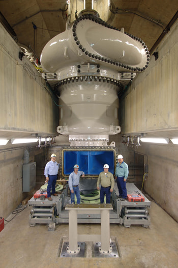

hitachi2
The pump's rating is 315 cfs with 1,970 ft of head and an 80,000 hp motor.
