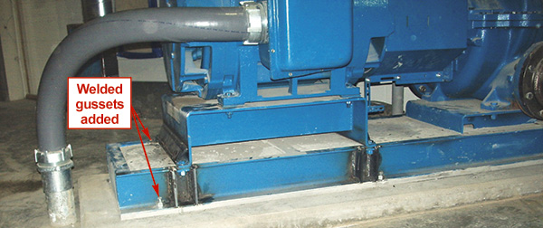

![Original base with first 'field fix'](/sites/default/files/0314/Figure-1-ITT0314.jpg)

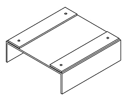

![Drawing of new motor saddle](/sites/default/files/0314/Figure-2-ITT0314.jpg)

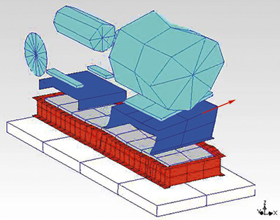

The following case history is offered to illustrate the concept. A new manufacturing plant was being constructed near Kansas City in early 2012 and the plant utilities building was close to completion. However, a problem was noted with the newly-installed chilled water circulator pumps. The pumps were between bearings, double suction centrifugal, 1,800 RPM, size 8x10-17 operating on VFDs. The reported problem was elevated turning speed vibration at higher operating speeds. Amplitudes of greater than 0.40 IPS-RMS were reported. This was unacceptable and the contractor was facing penalties on the project unless the issue was corrected in a short time frame. The first field engineering effort proved unsuccessful in reducing the vibration and took approximately two weeks to work through at a cost of several thousand dollars. The problem was investigated, but not enough to facilitate the engineering solution. In this case, the problem was identified as a resonant frequency using standard spectral vibration analysis, but no further investigation was performed to clearly define exactly which component(s) were involved, the mode shapes involved or the operating deflection shape of the equipment. The result was a vague definition of the problem. The next steps were contacting the original equipment manufacturer (OEM) for support. This was a positive step, but without complete information and a clear definition of the problem, the suggested field fix from the OEM was ineffective. It involved welding gussets to several areas of the base (see Figure 1).![Experimentally measured first mode at 25 hertz](/sites/default/files/0314/Figure-4-ITT0314.jpg)

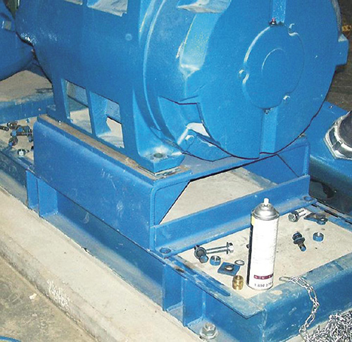

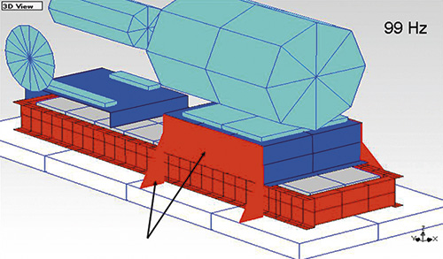

![Adding 3/8-inch plate to the sides of the original motor support](/sites/default/files/0314/Figure-5-ITT0314.jpg)
- The operating deflection shape at 1,498 RPM approximated the first mode shape indicating possible resonance.
- The first mode was a lateral rocking of motor base at 25 hertz
- The second mode was a longitudinal twisting of the motor saddle at 70 hertz

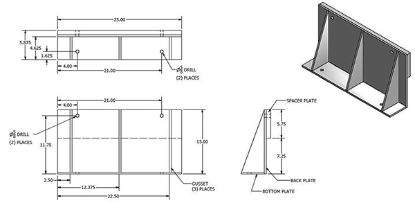

![Adding 'wing' style supports, 3/8-inch plate steel material](/sites/default/files/0314/Figure-6-ITT0314.jpg)
- The next step in the process was to define the assumptions and limitations. For this case, the list of assumptions and limitations looked similar to those listed below.
- Shifting the first mode to a value greater than 15 percent higher than the maximum operating speed will eliminate the resonant condition.
- The solution must be able to be fabricated and installed in less than one day per pump.
- The solution must cost less than $1,500 per pump.
- No piping or piping support modifications are allowed.
![Both wings and side plates](/sites/default/files/0314/Figure-7-ITT0314.jpg)
Specific Software Simulation Tool

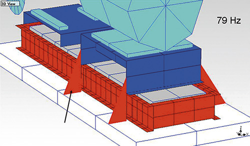

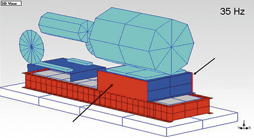

Steps four and five involved the use of a specific software simulation tool. The governing equations for the engineering analysis are part of the software package and involve the equations of motion and the experimentally derived modal parameters (stiffness, mass, damping, etc). The use of a software simulation tool allows the engineering analyst to simulate the impact of myriad structural modifications on the dynamics of the system. The goal is to determine what type of modifications would increase the first natural frequency of the motor/base assembly to 35 hertz or greater with a minimum of additional cost and effort. The accuracy of the predicted effect from the structural dynamics modifications (SDM) simulations was checked by comparing the predicted effect of the previous modifications with the test data obtained on the modified pump. Agreement was determined between them, resulting in a high degree of confidence that the SDM predictions were accurate. The results of several example SDM simulations are shown in Figure 5. (The predicted natural frequency of the mode of interest is shown in the upper right hand corner.)![Wing-style support](/sites/default/files/0314/Figure-8-ITT0314.jpg)
