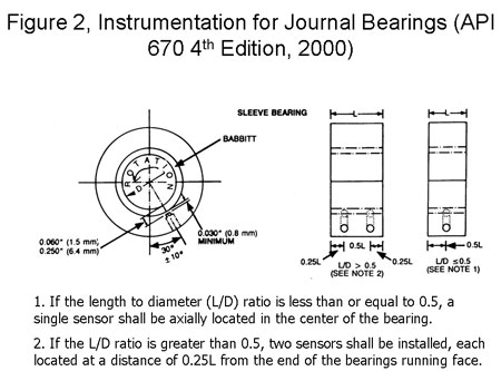

Sleeve Bearings
The probe or probes should be located 30-deg ± 10-deg beyond the point of maximum bearing load in the direction of shaft rotation. More precisely the best location is in line with the point of minimum oil film. See Notes 1 and 2 on Figure 2 for axial location of probes.

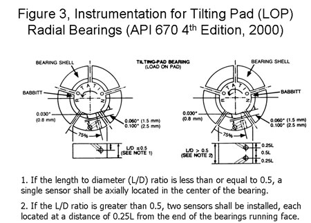

temperature-indicator-f.2.jpgTilting Pad Journal (TPJ) Bearings-Load on Pad
The probe or probes should be located in the pad carrying the greatest share of load, usually the bottom centerline pad. Probes should be embedded and located 75 percent of the circumferential pad length from the leading edge in the direction of rotation. For pads with self-aligning pivots, only one probe on the axial centerline is required regardless of pad length. For line contact pivots, see Notes 1 and 2 on Figure 3.

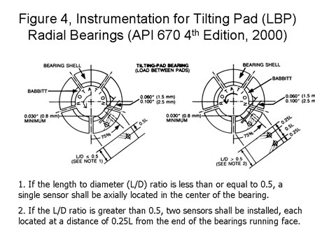

Figure 3Tilting Pad Journal Bearings-Load between Pads
The probe or probes should be located in the trailing of the two loaded pads in the direction of rotation. In this pad, the probe or probes should be located 75 percent of the circumferential distance from the leading edge in the direction of rotation. For pads with self-aligning pivots, only one probe is required regardless of pad length. For line contact pivots, see Notes 1 and 2 on Figure 4.

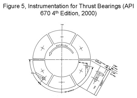

Figure 4Thrust Bearings-Tilting Pad
Probes or sensors should be located in at least two pads in the designated active thrust bearing, at the 75 percent-75 percent location, as shown in Figure 5. Regardless of the number of pads in a bearing, attempt to have sensors in two pads located in the bottom half of the bearing assembly at least 120-deg apart. When installing probes, the tilting action of individual pads should not be compromised.

  1. If the length to diameter ratio (L/D) is less than or equal to 0.5, a single sensor shall be located on the axial center of the bearing.
  • If the L/D is greater than 0.5, two probes shall be installed, each located 1/4 of the total length from each end.
