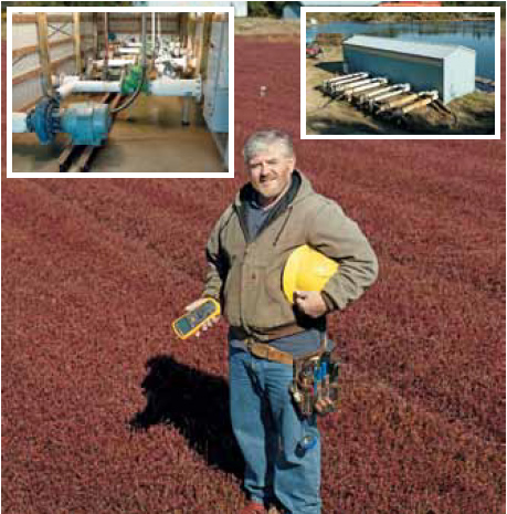

Andersson has 11 pump houses, each with between two and five pumps and just as many motors for those pumps. The motors range from 10 to 100 hp. All the fields have temperature sensors that relay back to the pump houses. If the temperature goes up or down too far the pumps come on to start the sprinklers, which then use water to adjust the air temperature in the bogs.
The equipment maintains the proper temperature of the fields 24 hours a day, 10 months a year. The cranberry vines must stay within two or three deg of their ideal temperature, otherwise the crop is damaged and the yield is reduced.

Since he started managing the farm in 1991, Andersson has worked on his pump and motor system to maintain the necessary temperature for the berries in his fields. Buchanan began helping him six years ago when he installed the farm's most recent pump house and its four 100-hp motors and pumps at a price of more than $100,000. Each pump can move as much as 1,500 gal of water per minute to provide frost protection, irrigation, weed control and flooding of the bogs at harvest time or when otherwise necessary.

Mother Nature not only provides hazards for the berries, it can also cause abuse to the equipment. Buchanan must be mindful of those hazards during maintenance of the farm's 27 motors. The salt air eats through insulation, and the constant presence of water slowly corrodes the motors and relays. “Windings fail faster. There is corrosion and insulation degradation ahead of schedule,” Buchanan says. However, equipment failure is not an option.
Buchanan has worked to eliminate failure by implementing a predictive maintenance plan. Each winter, he visits the farm for an annual inspection of motors, controls and pumps and checks for loosened terminals and connections and any damage from moisture or age.
On each predictive call, Buchanan is looking for changes in readings, and he checks the insulation and lining around each motor. “We want to prevent critical shut down,” he says. To do this, he compares all his readings against those he measured at the same time the previous year. He also tests for any power dips, looks for any damage to the insulation or the lining of the motor, and ensures that no feedback or deterioration is present.
