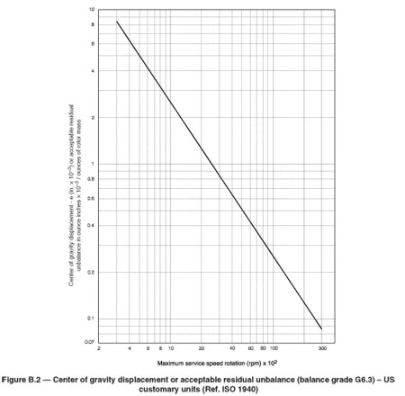

Q. How carefully must pump impellers be balanced to avoid unacceptable vibration levels when the pump is running?
A. Pump impellers are typically balanced in accordance with ISO 1940 balance quality grade G6.3 or better (see Figure B.2). This figure indicates the center of gravity displacement or residual unbalance acceptable for balance grade 6.3.
Depending on component geometry, it may be satisfactory to perform a single-plane spin balance. Components are typically single-plane balanced if the ratio of diameter to width D/b is 6.0 or greater. The width b is measured between the outside of the shrouds at the impeller OD.
Two-plane (or dynamic) balancing is typically performed otherwise.
Figure B.2 is used by entering the graph at the maximum expected service speed, such as 3,600 rpm, and reading the acceptable residual unbalance as 0.7 oz-in/oz. Multiply this number by the impeller weight in oz and the result is the allowable unbalance of the impeller in oz-in.
Balancing machine sensitivity shall be adequate for the part to be balanced. This means the machine is capable of measuring unbalanced levels to one tenth of the maximum residual unbalance allowed by the balance quality grade selected for the component being balanced.
Balancing machines are capable of measuring unbalance independent of its speed. When the value for allowable unbalance is determined from Figure B.2, it is not necessary to operate the balancing machine at the same speed as the pump speed.
The practice of component balancing is appropriate for a large proportion of rotodynamic pump types that can be proven to meet the specified vibration performance criteria while using clearance fits between the rotating component parts and the shaft. Residual unbalance grades are then determined to meet vibration performance acceptance levels while also considering the mass eccentricity effects caused by clearance fits and the resulting component runout. Clearance fits are preferred and used whenever possible to facilitate pump assembly and disassembly.
In many pump types and applications, however, it is necessary to use shrink fits and perform a supplementary two-plane (dynamic) balance on the complete rotating assembly to meet the specified vibration performance criteria. In these instances, the manufacturer and the purchaser should agree on the appropriate residual unbalance grade.
For additional detail on this subject, see the recently published HI Standard ANSI/HI 9.6.4 Rotodynamic Pumps for Vibration Measurements and Allowable Values.
