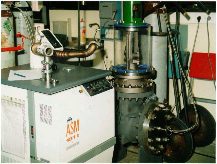

ISO Standard
The International Standards Organization (ISO) developed the ISO-15848-1 and 2. This two-part standard used information from a wide range of industry sources. The standard incorporates the testing of commodity valves as well as control valves. Industrial valves—measurement, test and qualification procedures for testing fugitive emissions of industrial valves—are described.
Part 1 addresses a classification system and qualification procedures for type testing of valves while Part 2 covers production acceptance testing of valves.
Figure 1. ISO test device
Part 1
Included in Part 1 is the testing of completely assembled valves using vacuum, bagging or sniffing (EPA Method 21), depending on which annex is used and the type and class of the valve. The standard uses helium or methane as the test fluid and only permits one adjustment to the valve packing every performance cycle.
Valves are typically tested vertically with horizontal as an option, with cycling rates based on the type of valve—isolating or control. Stem packing leakage is categorized as A, B, C and D, for both helium and methane, with A the lowest.
The amount of acceptable leakage is predetermined by the manufacturer or purchaser, and the difference between the leakage of helium and methane is not correlated. The numbers of mechanical cycles for isolating valves are categorized as CO1 – 500, CO2 – 1500 and CO3 – 2500. Mechanical classes for control valves are CC1 – 20,000, CC2 – 60,000 and CC3 – 100,000. Temperature classes range between -196 C and 400 C, with combinations of testing to establish the final ranges for service.
Part 2
This acceptance test defines a method for evaluating valves at the manufacturer’s site of valves already tested in Part 1. The procedure gives direction to the manufacturer and purchaser as to the required percentage of valves to be tested per production lot. It also identifies helium as the only permitted fluids and provides a specification of 6 bar internal pressure.
It is a room temperature test that requires that the valve be operated half open and then fully closed, leak checked and then cycled fully for five cycles with a final check for leakage at half open. Whether the valve passes is based on the required leak limits for the categories in ISO 15848-1 but with sniffing as the method of taking the readings.
Both parts are currently undergoing revision, and the final standard is expected to be published sometime later this year. The key changes are the addition of leakage rates for methane, the addition of category D, changes to the number of cycles required to qualify a commercial valve and a few others.

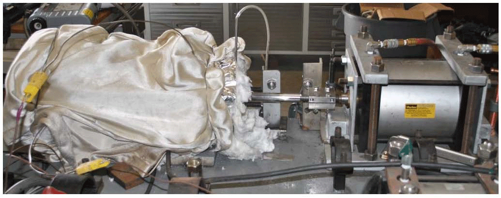

API 622
API developed Standard API 622 in response to the needs of the petroleum and chemical industries. The first edition of API 622 was designed to test fugitive emissions of valve packing, but it also allowed the valve company or packing manufacturer to test a completed valve.
The test has undergone revision during 2011, and the second edition was published in November 2011. The new edition eliminated the use of a standard valve and now requires the test facility to use a test device or rig that is designed to simulate a 4–inch, Class 300 rising or rising-rotating valve.
The test requires five thermal cycles from ambient temperature to 260 C (500 F) with 1,510 mechanical cycles, using methane as the test gas. Each set of ambient and thermal cycles is divided into 300 cycles per day and a final 10 cycles where the final leakage measurement is taken. Another key component of the standard’s improvement was the introduction of an oxidation test of the flexible graphite packing material.
This test specifies a limit of 15 percent oxidation during the 24-hour test and follows the procedure in Standard FSA-G-604-07, Method B. Other parts of the second edition cover ambient and elevated temperature corrosion, along with packing material composition and property evaluations. The leakage limit of the test is 500 parts per million (ppm) with a limit of one adjustment.
