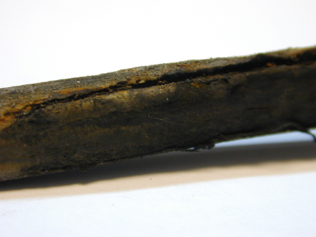

An early warning sign of chemical/steam incompatibility is extrusion (See Figure 1) arising from seal swelling. Chemical or fluid absorption is the primary cause of the swelling of elastomer seals, with the often-heard phrase ‘like-dissolves-like' providing an important guide.
Extrusion damage to a seal
Figure 1. Extrusion damage to a seal
For example, ethylene-propylene rubber (EPDM) is a non-polar elastomer. As such, it should not be used to seal a non-polar solvent such as hexane. However, EPDM can be used to seal against polar fluids, such as water.

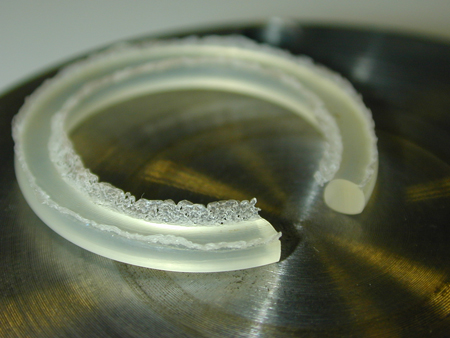

An early sign of FKM incompatibility is surface cracking. Initially, this may seem as though the seal has become brittle. The seal surface cracks are not due to hardening but to a reduction in tensile strength of the elastomer (See Figure 2). It follows that in applications in which seals are likely to be exposed to steam, peroxide-cured fluoroelastomers should be used.
Chemical-attack surface cracking
Figure 2. Chemical-attack surface cracking

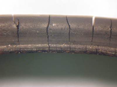

Thermal damage is a common cause of pump seal failure (Figure 3). As a general rule, elastomer temperature resistance ranges from more than194 degrees F (90 degrees C) for natural rubber (NR) through more than 626 degrees F (330 degrees C) for perfluoroelastomers (FFKM). Other elastomers offer temperature resistances between these values.
Running a rotary pump longer, under greater working demands, creates increased thermal stresses on both the pump and seals. Localized heat generated due to friction expands the seal, increasing the sealing force which, in turn, further increases friction; temperature at contact faces in rotary pumps can easily exceed 752 degrees F (400 degrees C), especially with lubricating media. Signs of thermal attack are an increase in seal hardness. The seal will take on a ‘compression set', where the seal does not recover when it is removed from the application.
Although pumps should be designed with sufficient cooling in mind, the heat-soak during shutdown can damage the seal or at least reduce the seal life. For this reason, it should be borne in mind that the temperature of the process is not necessarily what the seal will actually have to withstand. It could be lower or higher depending upon the location of the seal and the effectiveness of the cooling system.
It should also be noted that elastomer physical properties vary with temperature, so a material that has a tensile strength at ambient temperature of 1,450 psi, will be significantly weaker at more than 392 degrees F (200 degrees C).
For situations in which seals are continuously exposed to high temperatures, there must be sufficient free space in the seal groove to allow for thermal expansion of the seal. The typical coefficient of thermal expansion for an elastomer is 100 times that of its metal gland.
Failure to take into account elastomer expansion leads to extrusion of the elastomer from the groove. In extreme cases when extrusion isn't possible, the force generated by the elastomer will damage the pump. When extrusion occurs, it is best to seek professional assistance before changing the groove/elastomer profile.
Thermal attack is often considered to be a high temperature phenomenon, but the same problems can arise at low temperatures. The low temperature resistance of an elastomer is dependent upon its glass transition temperature, Tg. This is the point at which the elastomer changes from being a rubber-like material to a brittle material. (See Figure 3) An elastomer's low temperature performance is often overlooked when sealing problems occur.
Thermal embrittlement damage to a seal
Figure 3. Thermal embrittlement damage to a seal

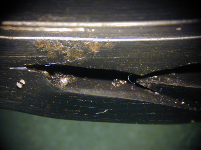

Sudden changes in pump pressure can occur in two cases: when a seal fails and when the pump stops unexpectedly. In both instances, the seal should be inspected for damage arising from explosive decompression or rapid gas decompression (RGD). RGD occurs when liquid permeates into an elastomer under high pressure. If the pressure is suddenly released, the liquid is vaporized, expanding and rupturing the elastomer. Signs of RGD damage are splits and blisters (See Figure 4).
Rapid Gas Decompression L-ring seal failure
Figure 4. Rapid Gas Decompression L-ring seal failure
A single incidence of RGD may result in catastrophic seal failure. Repeated RGD certainly will. Any incidence of explosive decompression, whether  due to seal or pump failure, should be investigated immediately and action  taken to either reduce the pump pressure or change the elastomer to a RGD  resistant grade.
