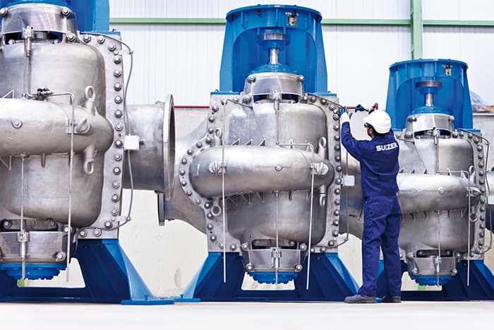

In some situations, the specification of a centrifugal pumping system will involve multiple pumps, either in parallel or series configurations. This enables a number of smaller pumps to deliver much greater flow or head, depending on the pump arrangement, which may be preferable to a much larger, single pump.![Extensive testing blue shirt](/sites/default/files/1217/SulzerAME111_Centrifugal_Pumps_pic2.jpg)
