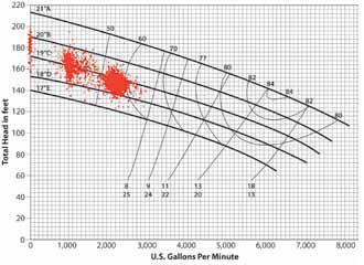

The pump in question—driven by a medium voltage 250-horsepower motor (see Figure 1)—was used to pump “white water” (which is filtrate from the wet end of the paper machine) from a large tank to several points in the paper-production process. The motor failure was an unexpected burnout, but the pump had a backup motor so downtime was minimized. With the system back online, mill staff asked the team to investigate the next step for the spare equipment.
By asking detailed questions about the system, the team concluded that the pump was supplying white water to more than a dozen discharge pipe legs, some of which were throttled with control valves. To get a better understanding of the system’s layout, the team did an on-site evaluation of the whole system. Even with initial sketches, it took hours to walk the line and map the system (see Figure 2).
Then the team interviewed the plant maintenance staff and operators to determine if pump operation varied. These interviews revealed that the pump’s flow rate varied depending on the process requirements, but it was not automated with a control system. The flow was controlled by an operator who electronically throttled a control valve. With this approach, the pump’s operating point (flowrate and developed head) depended on production loading and the liquid levels in tanks in other parts of the system.
Field measurements were required because no process data and no previous data logging of pressures or flows were available. Using a portable, clamp-on, transit-time ultrasonic flow meter in conjunction with pressure transducers piped in at the suction and discharge of the pump, the team measured the pump’s characteristics. Data logging took place throughout a 10-day period. Once completed, the data was offloaded and compared to the pump curve. Pressures and flows were taken on the same interval and were superimposed over the pump curve to illustrate the pump’s operating regimes.
As shown in Figure 3, this oversized pump was operating far off its BEP. In fact, the pump was operating inefficiently and sometimes under dead-headed conditions. Through a rigorous bin analysis of the collected data, representative flow regimes were defined and used to identify the potential energy savings if a smaller, more appropriately sized pump and drive motor were installed. The pump was an end-suction centrifugal pump, but because of its location within the system, it was a static lift application. A VFD would not provide the full energy savings normally expected in an otherwise flow-dominated system.
The analysis indicated that the pump was oversized and was operating in inefficient hydraulic efficiency ranges. The mill agreed with the team’s recommendation to reduce the pump size, and the new pump is now driven by a low-voltage 125-horsepower premium efficiency motor with VFD control. The properly sized pump can adjust flow without wasting energy across a throttled discharge valve. After the recommended unit was commissioned, the mill began saving more than 700,000 kilowatt hours per year, valued at $21,000 annually.

Pressures and flows from the oversized 12 x 10 x 21 pump were taken on the same
Figure 1. Pressures and flows from the oversized 12 x 10 x 21 pump were taken on the same interval and were superimposed over the pump curve to demonstrate the pump's operating regimes.
