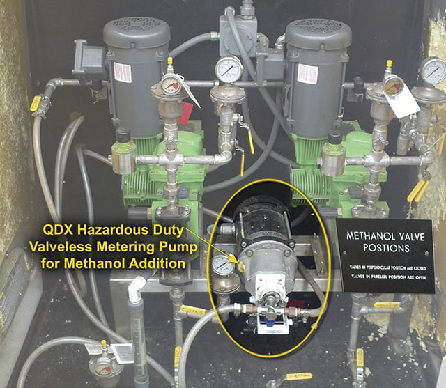

Valveless piston pumps rely on one moving part, a rotating and reciprocation ceramic piston, to accomplish both the pumping and valving functions. With only one moving part in the fluid path, internal check valves, present in diaphragm and other reciprocation pump designs, can be eliminated. The technology is precise and works particularly well in low-flow wastewater treatment operations. The use of sapphire-hard, dimensionally stable, ceramic internal components allows precision manufacturing with tight clearances. The ceramic components for both the piston and mated liner are wear-resistant and chemically inert. As a result, the volume of the pumping chamber remains the same for millions of metered injections. This, as well as the elimination of multiple check valves, provides a metering pump that can self-prime down to the micro-liter range and never lose prime. This is the result of eliminating check valves that don't seal well enough to prevent backflow. When metering methanol in the denitrification process, one valve-less piston pump is driven by a one-third fractional horsepower (HP) hazardous-duty motor rated for Class I, Group C,D; Class II, Group E,F,G. Image 1 shows an installation in a non-heated outdoor enclosure, at a community college wastewater treatment plant.How They Work
